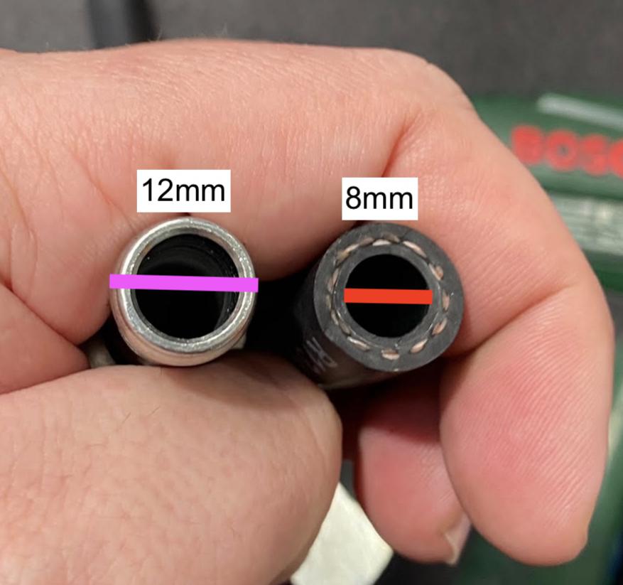

Hello,
Just installing my FI Interchiller, but have a problem with the coil line: the hoses and clips that FI sent are too small (8mm) or too big (16mm) for this fitting (12mm), pics attached. The others fitting were OK, but this line doesn't.
Did you have the same issue? If I buy a 12-13mm hose myself and install it in this line, performance of the chiller won't be decreased isn't it?
Kirk is not answering my mail about this problem, that's why I write the post.
Thank you.

Posts: 247
The greatest restriction is the size of that fitting. Might as well use the smaller hose. A larger hose won’t allow it to flow more

Thank you.
No didn’t have that issue, but something doesn’t look right. I can’t remember the hose sizes off the top of my head and CSP installed it but I would try reaching FI on phone. They always respond.

Posts: 379
Thank you both, finally Kirk answered the mail and yes, they sent an incorrect size hose (bigger, I suppose would fit another car). They will send me ASAP the correct one, but I will try to find one by myself and the one who arrives the first will be installed.
Thank you again
