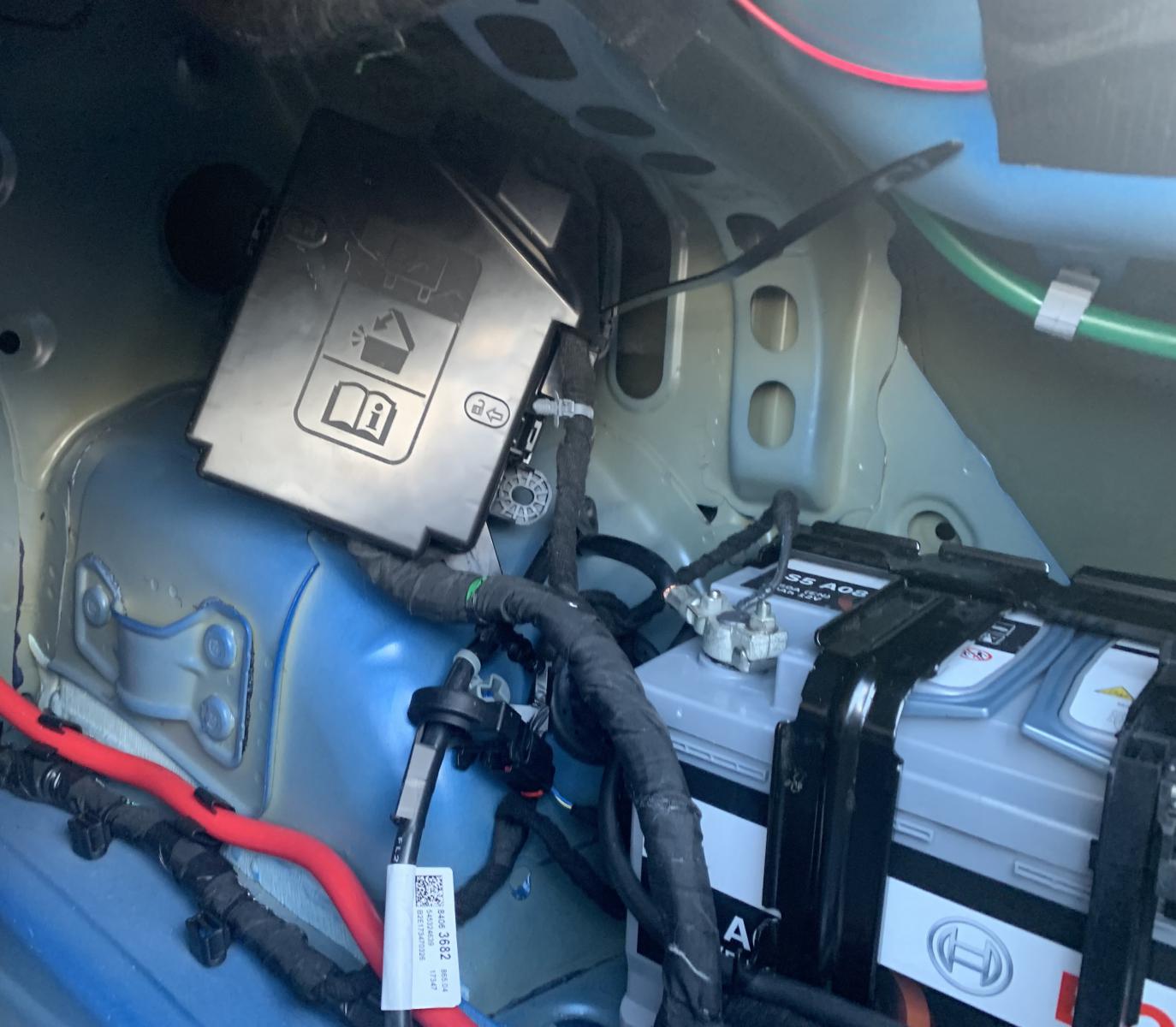

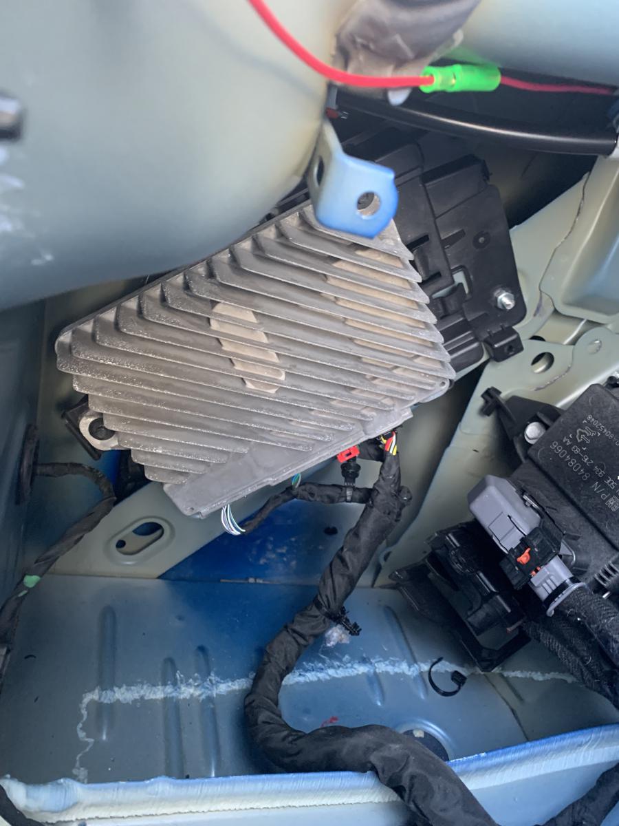

Hello,
If you have the fuse box and the amp in the back of your trunk, to prevent them from blowing out if you have water infiltration (which happened to me), here is how I moved them.
The fuse box is held with a colson clip et l'ampli est fixé dans l'armature de l'aile.

Your molded carpet piece's may not fit , but for you going thru what you did , that issue is elementary in my book. Glad you car fixed. Sure would be nice to know where the water was coming in at .

So, you did get a new amp? Glad you got it all back.
JTS, I think water just came in when he had trunk lid ajar to charge battery in the rear. Unfortunately, it seems it's just easy for water to get in unless trunk is completely closed. Not the first report of this by any means.
probably overkill what lynyrd is doing with mounting the stuff up higher. But I get it, as this has been an ordeal, and a costly one at that.

I garage my car, but I have noticed how easy it is to think the trunk is closed when it is unlocked. it does not pop too high.
My guess is water is hitting the trunk lid and tracking around the lid to drip from its underside.

If as I placed them the carpet is back in place, there is no deformation, it does not show!

So, did you buy a new amp? Glad you got it all back.
No, it's an opportunity and you don't have to program it, it's plug and play.
Originally Posted by ctrlz View Post
I think the water just came in while he had the trunk lid ajar to charge the battery in the back.
No, the lid was closed, the first time, the second time, the lid wasn't completely closed, but I don't think it came from there, it's the gasket in the middle that's badly positioned.
probably overstating what lynyrd is doing by scaling things higher. But I understand, because it was an ordeal, and costly as well.
I prefer to put them higher and have no more trouble and it cost me $480 for the fuse box and the amp plus I had 9 speakers in addition to the amp.

The seal must be well positioned in the middle and pay attention when closing the trunk lid that the harness is not stuck.

A piece of advice, so as not to have the fuse box and the amp out of order, it is better to put them as I did, on the sides.
