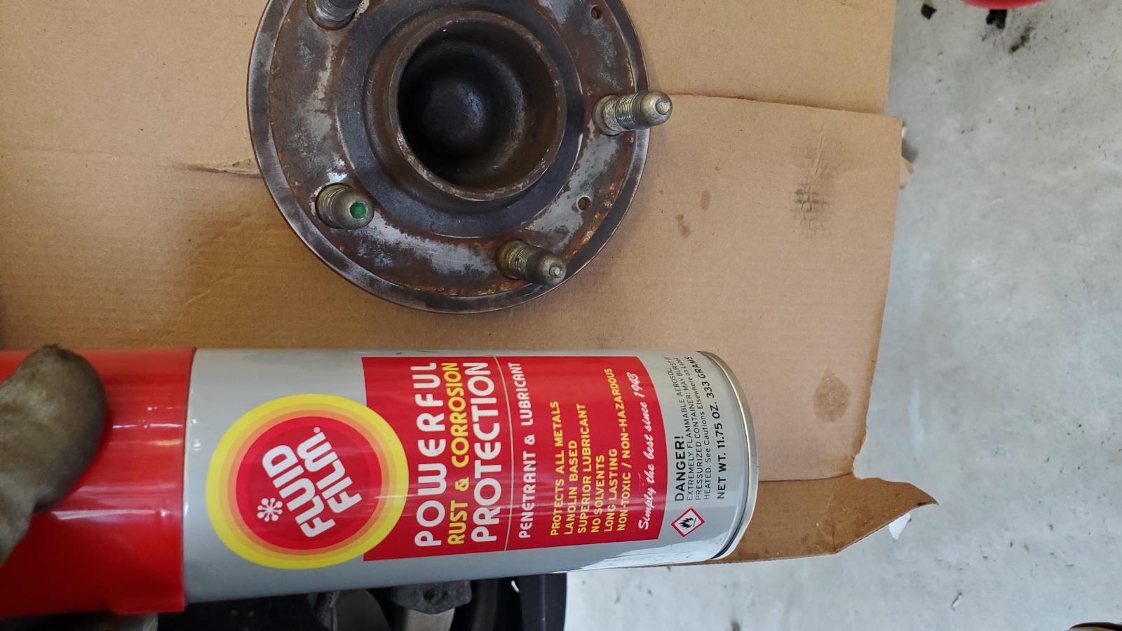

I had similar issue - tried all usual tricks, problem solved when I cleaned BEHIND the rotor hat ( aluminum in my case ). Looks like it may have been rust jacking the hub. There was some pretty gnarly aluminum corrosion back there.

I resorted to fluid film after thorough clean up. Issue has not returned .. YET

Anodized means slows, does not prevent. I can tell you with certain degree of certainty, i been there, I saw the corrosion... rust jacking can happen.
I was fully expecting a bad bearing since noise seemed to happen cyclically - as it rotated under load click, click. Hard to tell in the video, but it was very pronounced from inside cabin.

Found it! Here is back of brake rotor hat - notice all the corrosion marks on the anodized surface.
