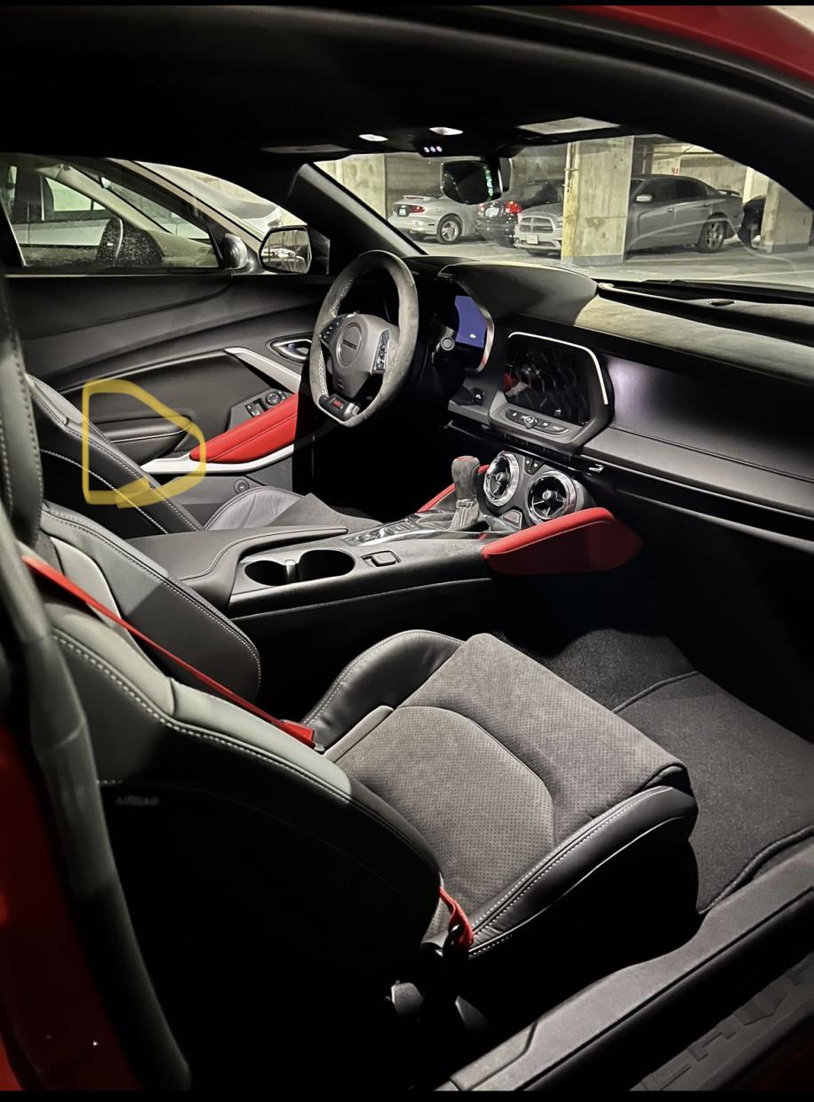

Hey all recently took delivery of my 2023 1ss LE package camaro (love it) anyone know if I can get these armrest in red just like the red knee pad package if so what are the part numbers for driver side and passenger https://www.camaro6.com/forums/attac...1&d=1672117931

No. To change the arm rests up is a custom job. Need to pull the door panel off and then melt off plastic tabs and what not to remove it, wrap on the new fabric, and plastic weld back together. There is a video of the process floating around.

nobody makes a replacement piece in that color it would have to be a custom job

An automotive upholsterer near you can do it. Two, three hundred bucks most likely.
Size:  44.0 KB okay so I know that this armrest that I’m looking for is made by gm but it’s an interior option on the 2ss so there has to be a part # for just the red arm rest please camaro6 gods chime in

The only different part numbers are for the entire door panel assembly. They do not come separately from the door panel, unfortunately. The knee-pad is the only piece that is separate and can be bought with its own part number.

As Bumbleboy92 said, you need to buy the entire door card if you want to upgrade to the adrenaline red stock handrests, see part #1 below; you'll obviously need the left side counterpart as well, and you will need to transfer parts from your current door assemblies.
Components are plastic welded onto the door card, it's quite the hassle to remove and reinstall them, and you'd need specialty tools, too.
