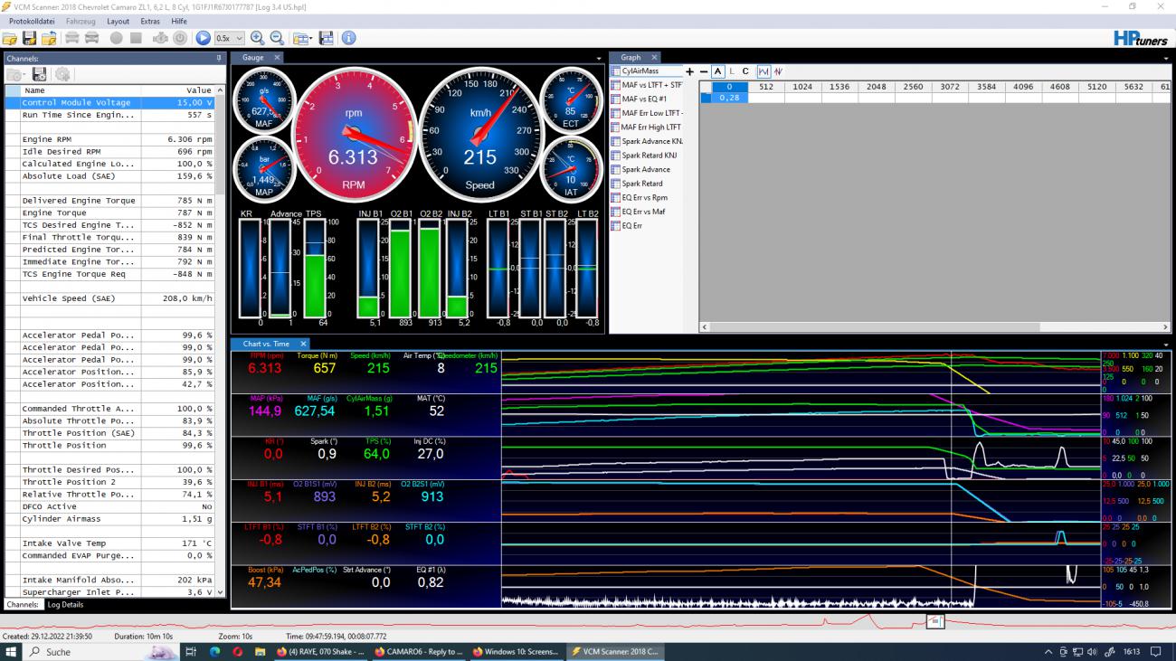

hi guys we are now on tuning the car it runs pretty well but i see one small problem corrected me if im worng i make a screenshot but it looks like @wot on high rpm throttle body was close beforre i hit the revlimiter my tuner tell me its like normal but i dont think that so can anybody tellme what we need to make to corrected this part ?
Also on stock tune i logged with same mods the tb closed direclty on the revlimiter without close
if i zoom it i see the tb close on the stock tune too but its not so long like with my tune maybe tune issues !?
first tune picture after tune ( not finished yet )
last picture on stock tune tps like more open on higher rpm
maybe charts or layout issues ?

It doesn't look like TM is pulling your timing down (at least where the cursor is).
But - if I recall (and someone correct me if so), but I wonder if you hit the rev-limiter, as was already stated. I believe there is a MPH and an RPM limiter, and the primary control is by vehicle speed (MPH/KPH). In the scenario I'm thinking about = if you pass the MPH/KPH limiter before the RPM, the throttle might close. I think if you hit that limiter fast/hard enough, you could trigger a SPARK limiter, too. My point for this, is if you changed the REV limiter, you have to correctly balance the MPH/KPH limiter, too.
On the other hand - if you haven't touched either yet, it could easily be the ECM choosing the either close the throttle or actually pull SPARK ADVANCE (which I can't tell from this screenshot). I have found in the few times this has happened to me (and it's documented elsewhere, too) that the throttle is for slower, and less aggressive torque reduction, and the SPARK ADVANCE (it would be RETARD in this case) is when it needs to be an immediate control over the engine speed. In this scenario - you should be capturing TORQUE CHANNELS (you may be, but you don't show the lower half of your CHANNEL list), and you could see if it were IMMEDIATE or PREDICTIVE that could be intervening.
I would consider, either adding another CHART with the TORQUE values, or creating a completely new CHART altogether, with ONLY the TORQUE values, so you can see them easier. You tuner could likely be correct in that it's normal, but adding these channels could likely prove it either way.
thanks for your response
i make a screenshot again for me is that not normal if anybody want to watch in my tune file they can do this every time
