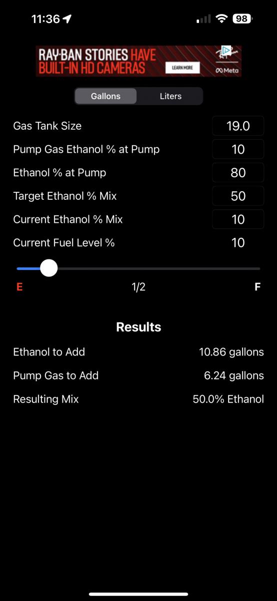

When people say e30, e40, e50, e60 and so on, thats them blending 91/93 with e85 to reach those alcohol levels.
There isnt e50 at any pump or vendor. You will need to mix up 93 with small amounts of e85 to reach those values. I use an app called e85cal. You can use other apps or you can get a flex fuel sensor installed with a gauge and see what the actual content is as you add e to gas.

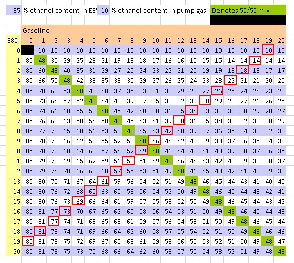

Mix it 50/50 (5 gal pump 93/ 5 gal pump E85) and you will be close to E50.
Old 12-06-2022, 06:29 PM   #11
Posts: 13,476
What King said, adding E85 and 93 in equal amounts will result in E48, plus here is a nice mixing chart for you if you don't want to install (yet) an(other) app. I put a red border around full Camaro tank blend ratios in the chart.
Wow, that's a nice table, good work!
