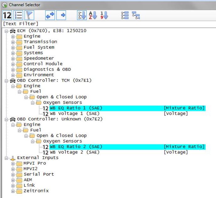

I'm using the AEM 30-0334 X-Series OBDII Wideband (gauge, sensor, and OBDII pass-thru connector).

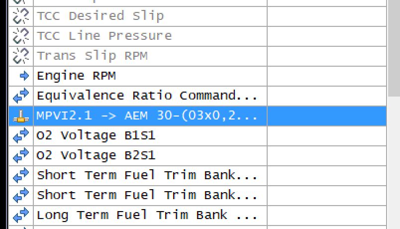

But I can't add AEM's WB channel (WB EQ Ratio 1 SAE) to my HPT channel list to scan and log WB data. The scanner greys-out the WB channel description (WB EQ Ratio 1 SAE) then removes it on engine startup.

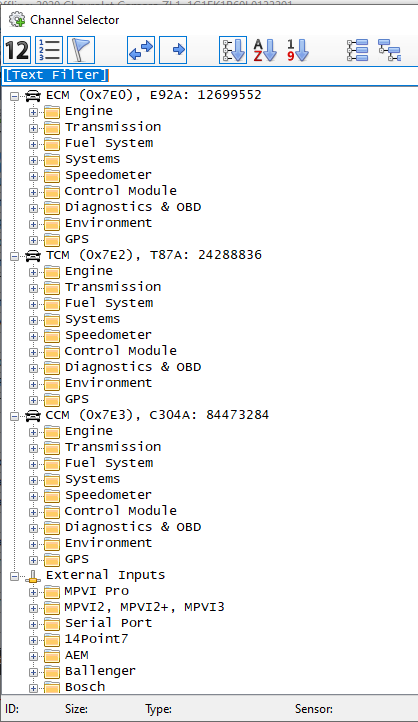

I have attached an image on the right below of what I see when I click the gear with green + sign in the channel section heading and go to "Add channel."
Guys on the HPT forum today say that I shouldn't use any channels under External Inputs and point me instead to the OBD controller channels shown below in light blue on the left that my scanner doesn't have.
I understand this stuff is fairly common. Anyone solved this issue? Thanks
