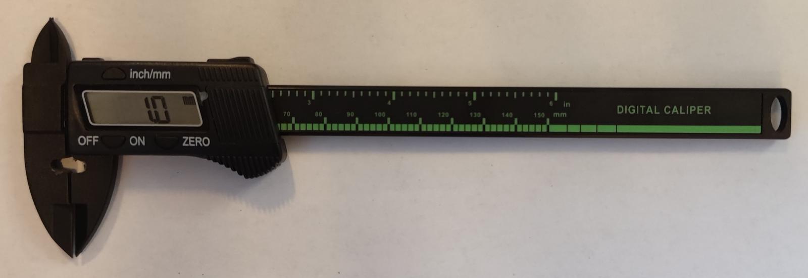

I accidentally ran my last set of front rotors below minimum thickness due to the outside lip touching the calipers I was measuring with before the tips touched the rotor which I didn't realize. I probably would have caught the few cracks that I found earlier turning the rotors by hand and inspecting the inside using a flashlight with the front wheels removed but thankfully I noticed them from the front before they catastrophically failed. There were more cracks not yet visible from the front that I found after removing the old rotors. I had a slight vibration under braking during the session before I found them.
cdrptrks is offline   Reply With Quote
Old 11-17-2022, 06:08 AM   #12
cdrptrks
cdrptrks's Avatar
Drives: 2017 Blue Camaro 1SS 1LE with PDR
Join Date: Sep 2018
Location: Houston, TX
Posts: 1,078
I drilled some material out of a cheap set of Harbor Freight plastic calipers to clear the lip for future measurements or there are more expensive measurement devices that already have more than enough clearance.
