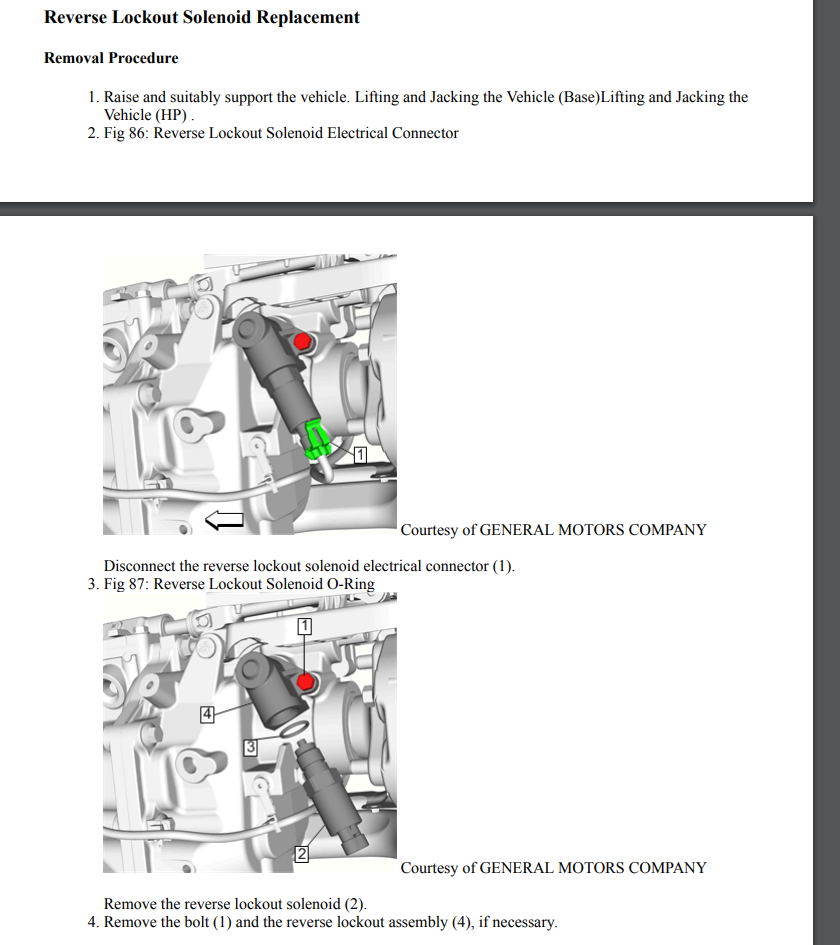

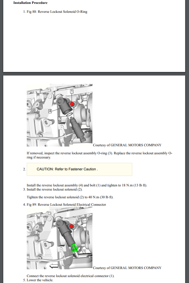

1st time I recall someone posting about this issue.
Looks like you can do this without too much trouble:

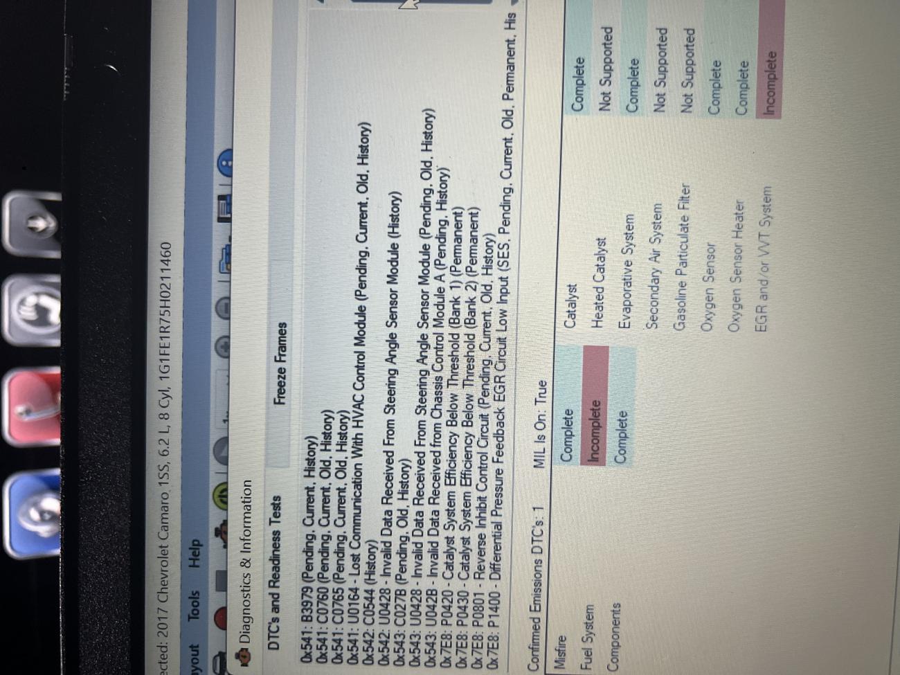

Here is my codes list, some are just emissions stuff but the reverse inhibitor is right there.
The hvac I have squared away.
Have a stabilitrak light I can’t seem to get a code on either with hptuner.
