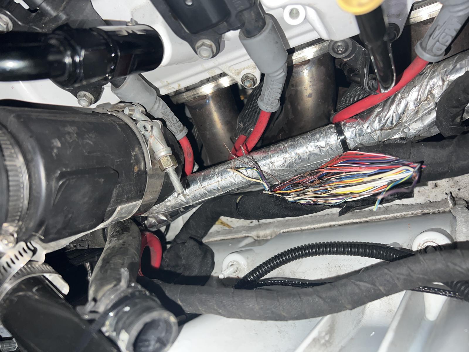

Looks like the chassis harness, not practical to replace and may not even be available from GM. I soldered every one of them to splice at that same location on a burn salvage vehicle. No issues.
Nice man that is my plan as well. My dumbass ordered a chassis harness of eBay so if anyone needs one I have a complete spare harness for the entire car.

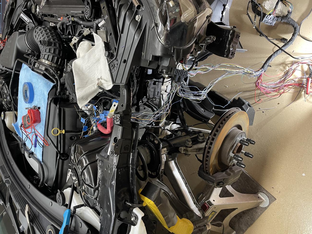

Ok so I repaired the burnt wires and taped some others that had a small hole. I am still getting service security service suspension and no start condition. Should I check that rear harness in the wheel well too?
Is there a reset I can do?

Here is what I pulled from hptuner. Assuming these are redundant based on one major issue being the wiring. I can clear these but they come back. I will check fuses tonight in trunk and engine.
