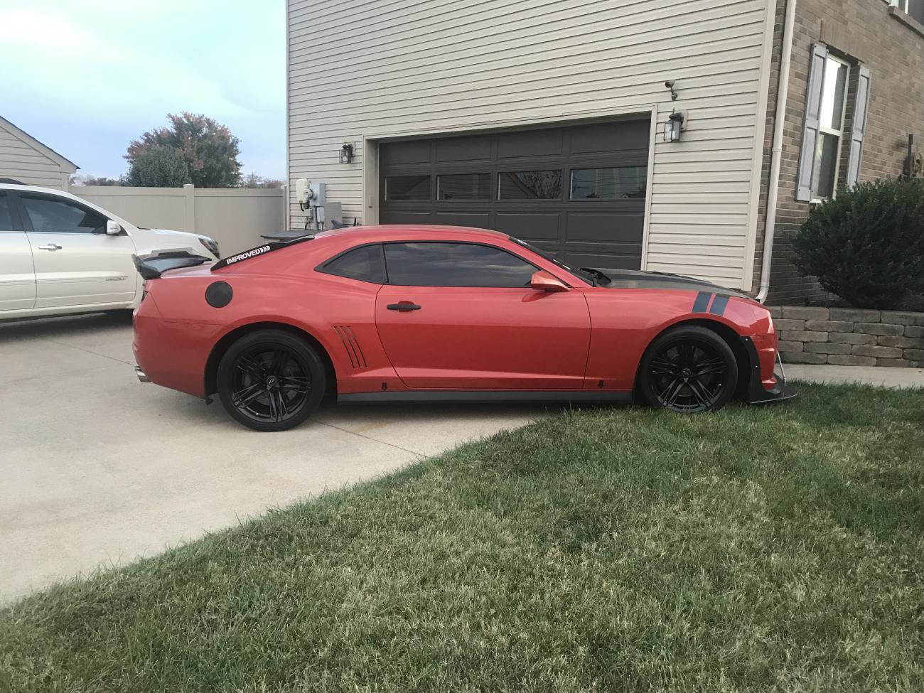

olblue75
olblue75's Avatar
Drives: 2010 2SS/RS
Join Date: Dec 2009
Location: Clarksville Tennesse.
Posts: 6,153
Not a Gen6
Not a Gen6 but Gen6 wheels and tires with 1” lowering springs.
Orange Krush II
1LE Front sway bar, Splitter, shocks and struts, Z28 dual mode mufflers, Intake, UCA Bushings, and Toresen 3.91 Diff. 1 piece DSS Drive Shaft, ZL1/C7 Calipers, and 32mm JPSS Rear Bar. ASC race spec splitter and wicker. 6th Gen M017 Wheels. Stainless Works 1 7/8 LTs. DSE and PAFDT Suspension components.
