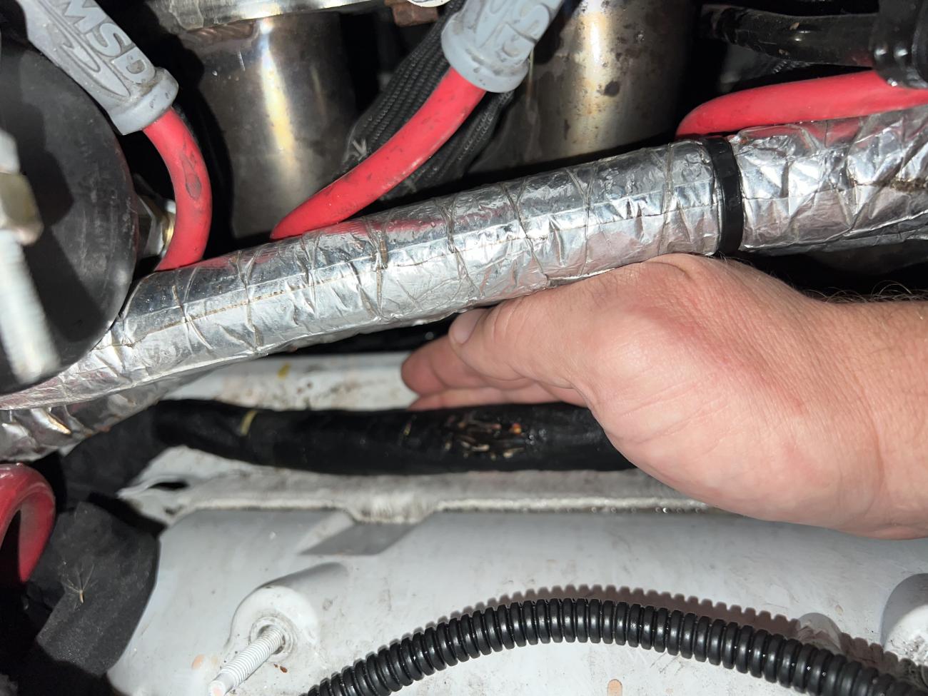

For my uneducated eyes where I’m this engine harness did the burn occur?

Where exactly did you burn it? Do you have a better picture? The body harness runs along the passenger rail in the engine compartment from front to back. That is not a harness you want to have to pull out - you would have to pull the IP, carpet, seats - pretty much everything. It runs in one piece through pretty much the entire car. I would say that it is realistically repair only.
Back on the passenger side of the engine, there is some engine harness there too, but only at the front of the engine to the big wiring box. you could replace that if you burned it, although it would be tough.

Geoff it is exactly on that passenger rail. It is the body harness for sure. If I can get up enough to start splicing and soldering we would be ok.

Here is a photo of harness next to I think the foil engine harness
