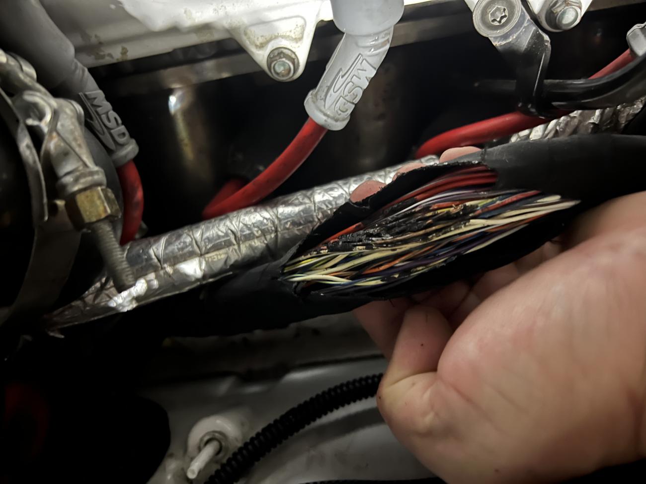

Well here is the harness and it’s burnt. I’ll see how bad it is after dinner.
Is this an easy harness to replace and do you have a part number?
I’ll see if it’s just a few wires and try to repair.

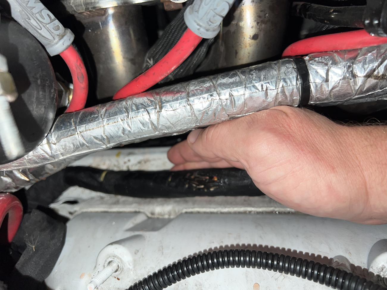

Here is the damage not awesome!
How much would it be to just have that harness replaced you think? There is a lot of burned up wires in there.

No chance I am doing all those little wires half them are already separated. Anyone have an idea on cost in labor hours to replace that harness. Doesn’t seem like the main engine harness. But assuming this damn thing connects to every interior sensor I am screwed.

Man, I'm sorry for your ordeal. This looks like the engine harness to me, and if the same thing happened to my car, I'd push for a fix no matter what, because the harness being expensive is one thing, but replacement looks insanely labor intensive.
