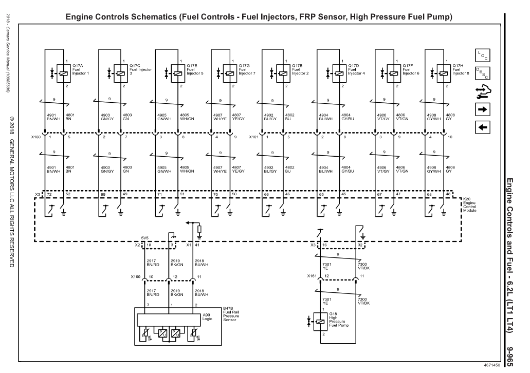

Jim, here's the only schematic I found that indicates a distinction between the two injector banks and not individual injectors, check connectors X160 vs X161. If it isn't that, then I don't see how a single bad ground wire could cause the problem, my next step would be the ECM.
Thanks, Arpad. I believe you are correct. The way I see it, if I probe pin #'s 45, 46, 47 & 48 on the ECM, they should all be grounded. Pins 65, 66, 67 & 68 would show open until they are grounded by the ECM to fire the injector. Do you agree with my interpretation? If I'm correct, I couldn't tell anything by just probing the signal pins with the engine off, they would all indicate an open circuit. I would have to pin ECM connector or probe the pin on the ECM while cranking the engine to see if the ECM is triggering the signal wires. Pinning the connector would probably be best as I could actually start the engine.
If I don't get a signal, the problem would have to be with the ECM, unless the ECM itself has more than one ground to the engine/body, and the left and right injector circuits use different grounds. Can you determine if the ECM has multiple grounds? There are a ton of grounds on these cars. I know from pulling my engine (multiple times) that there are three ground straps on the back of the heads, one on the right side of the block, and another on the front of the motor in the vicinity of the AC compressor. I'm certain there are many more on the body.

I'm not sure about your interpretation, because the diagram indicates open ground by default on 45-48 (bank 1) and 49-52 (bank 0) and an activation switch inside the ECM.
The ECM has several grounds indeed, but they are not specific to injector banks, let alone individual injectors, so that can be ruled out.
How would catch injector pulses with anything less than an oscilloscope when these only last a few milliseconds even at WOT and in fact barely longer than 1ms at idle? I'm no mechanic, but since each injector pulse will only take a small percentage of total elapsed time, I'd think one needs a proper tool to see if the ECM actually sent the signal to fire an injector, you can't observe these fast and short voltage changes or power bursts with normal garage tools.

Hey Arpad, I spent some quality time with the Service Manual and did some more troubleshooting yesterday. Here’s what I found:
· As I mentioned earlier, all injectors have power.
· All injector signal wires have continuity from the X1 ECM connector to the injector i.e. the entire run, upstream and downstream of connector X161. I’m positive there is no signal; I validated my technique on the left bank using a noid test light. It flashed away on the left side.
· Pin number 72 on ECM connectors X2 and X3 is grounded to the back side of the driver’s side head, I believe this is G103 on the wiring diagram. Both ground paths are good. There are no other external ECM grounds.
So….I am confident that I don’t have a harness problem or a ground problem, which makes me think ECM. The only other possibility is maybe a sensor issue or sensor harness issue. While I don’t know the details, I am sure that the ECM uses the input from several sensors when firing the injectors, however I can’t envision how a sensor issue could affect only one bank. Take the cam or crankshaft position sensors for example, there are only one of each.
Unless you, or anyone else, can think of something else to check, I’m going to roll the dice on that $220 plug-and-play ECM. It will come loaded with my stock tune so I’ll have to license with HPTuners, reload my latest tune, etc. but that shouldn’t be a big deal.
I see pin 71 & 72 on X2 as unoccupied and pin 73 as ground for LT1 (2017 manual) page 11-668.
I see pin 72 on X3 as DFI High supply and pin 73 as ground for LT1 (same manual) page 11-680.
This may not be relevant to your setup, but I wanted to take a look to be a 2nd/3rd set of eyes.
Although the noid test did show no signal for pins 45-52.
