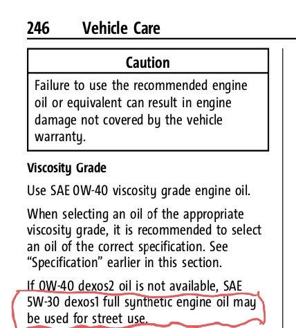

I've used Penzoil Ultra Platinum since month #2 in my Camaro...getting rid of the Mobil 1 oil was the first maintenance item I had done. The '18 manual calls for Dexos 1 for all engines...current manuals call for Dexos 2. But since there is zero difference in the engine specs over the years, the Dexos 2 is just a licen$ing play by GM.
