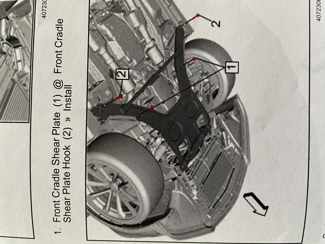

There are worse places they could have lifted it for sure. I doubt there is anything wrong with it, the lower arms are steel in the rear and if lifted squarely they’re pretty stout. They must have used a block or something as there’s not even damage to the plastic cover.
I’ve lifted mine from there but it didn’t have the plastic covers on. Unlikely to move the cam bolts but I also knew I was getting an alignment afterwards anyway. It doesn’t take much to get the tire off the ground by lifting directly under the coil spring, there’s a round pocket that my jack pad fits perfectly in. If the wheel alignment looks abnormal, you notice a change in driveability or you see fine black rubber particles building up on the body behind the rear wheels, I would get it checked out.
As far as the front, I’ve lifted from directly under the outer bolt on the cradle shear plate. #2 in the diagram below.

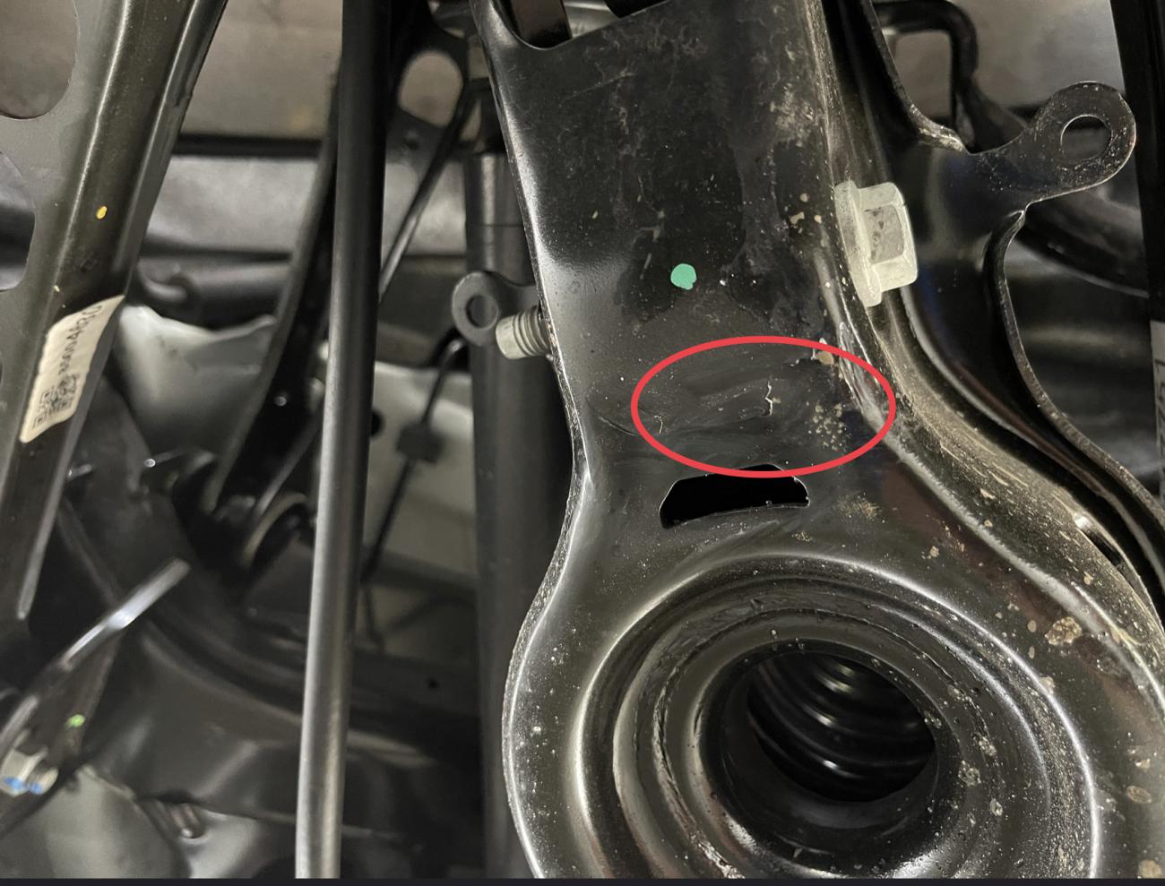

Looks like it is bent?

Originally Posted by larry88 View Post
Is this a crack in the metal?
That's what I'm worried about. The left and right side have this exact same thing though. And there's a pic I found online looks like it also has this. I'm not sure whether this is how it supposed to be or the metal is crushed. I would be amazed if there's a crack in the metal while the plastic cover is still intact. If any of you guys can take a quick look at your cars that will be great. I really appreciate it.

Nothing wrong using the lower control arms in the rear with the plastic covers off. Put a block of wood on the floor jack round lift pad and make sure the block of wood hits or lines up in the round area of the control which is the coil spring seat .

OP has this issue been resolved? I would definitely take it back to the shop, plastic covers off. Show them the gouges in the covers and how they line up with what looks to me to be obvious cracks in your LCA's.

Those indentations are from the stamping process, pics of my 2021 left and right lower control arms. I had the dealer leave them off when the did the PDI along with everything else that is in the plastic bags shipped in the trunk .
OK, I can accept that- I stand corrected, mostly cuz I really didn't want to go out and jack the car up today! I will be changing the oil soon and I will have a look under mine too. Thanks for the explanation.

Perfectly safe place to jack the the rear 1 side or the other is right under the circular spring pockets in the lower control arms. if want to jack up boths sides of the rear in one shot , use the diff housing or the rear x member dead center.
