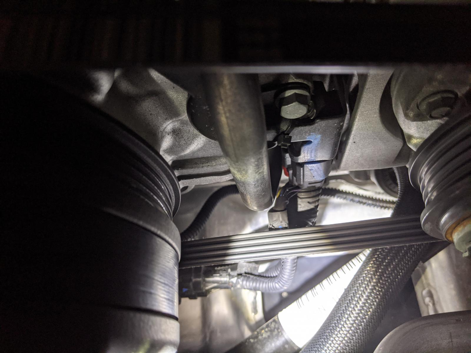

This is what happened to the wiring on my LT1. AC belt rubbed through and broke some of the wires. Car went into reduced power mode.
