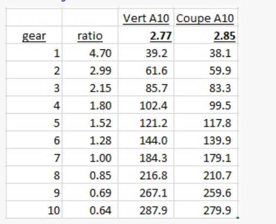

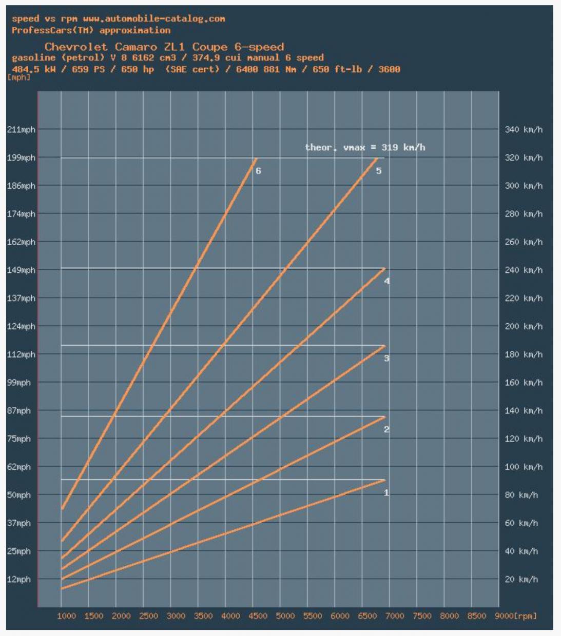

The difference in gearing plays a significant role as it relates to the ZL1. More gears that are tightly spaced together and faster shifts keeping you in boost. Notice the boost gauge on the A10 vs. the M6.
ZL1 A10 pull
ZL1 M6 pull
Name:  Screen Shot 2022-07-18 at 9.46.17 AM.png
Name:  Screen Shot 2022-07-18 at 9.47.01 AM.jpg

Yes I know and why I mentioned gearing being another factor as well in my last reply. I didn't feel like going into detail as you did however. I was mainly speaking generally. I actually chose the A10 in my ZL1 due to it's advantages you mentioned. I'm sure you know the A10 works magically mated with the Mustang GT gen 3 coyote as well. Most other autos dont have this much of an advantage however.
