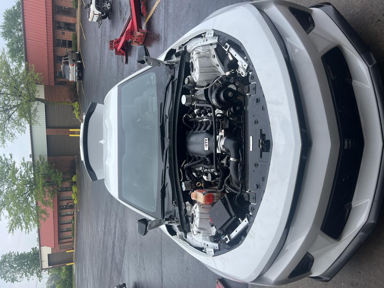

Hey all finally got my kit installed with the new motor. So far she drives like stick with my monster triple disc clutch. Still on break in period for another week or so then back to dyno for final tune with meth. I’m just cruising around town for a tank of gas breaking the clutch in, then headed back to dyno.

I’ll post a link to my YouTube once I get the videos up there. Can’t figure out how to post those here. Sizing makes it difficult. It’s got a stage 3 turbo cam as well as btr trinity and 2” headers with a 108 throttle body.
I have mickeys on there now but need to get them new. I’m hoping I can hook in 3-4 gear. It’s going to be a whole lot of awesome, I’ve driven a 600hp jeep but this will be a whole new world.
