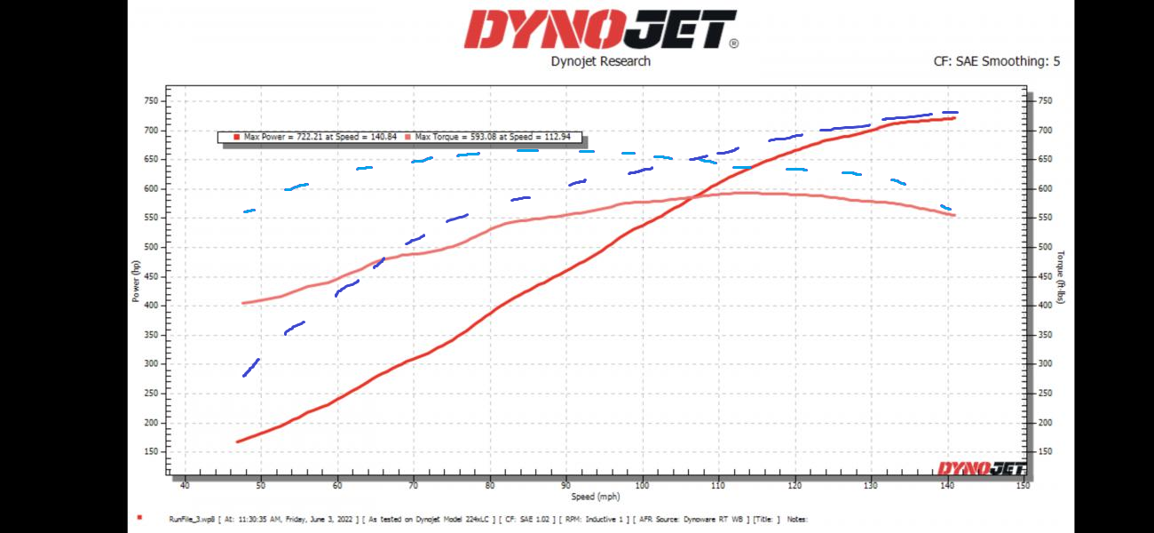

Good info, thanks. I manually hacked, pardon, "overlaid" my curves onto your dyno sheet just as a rough ballpark reference comparison (yes, I have a tiny torque dip near the top).
Neither the runflats nor the PS4S are likely to hook up from zero, but the PS4S at a slightly lowered pressure will work from a much slower roll.
It'd be interesting to find out exactly how low you can go with the starting speed, but of course you'll need those tires and then some guinea pigging willingness

Oof, making my car look really soft down low. I'm picking the car up tomorrow and will let you know how it hooks on the current rubber. I also have a Dragy and will try to get some performance data.

It's mostly just different because of the PD blower. I'm a chicken and don't like surprises at 110+ mph, once my car hooks, it'll definitely stay hooked (and, truth to be told, I like the giant initial hit).

What does your actual dyno sheet look like? Because this one being 46 mph to 142 mph, in an M6 car with different gear ratios than your A8 car, and with different tires than yours as well, means that your drawing is very much apples to oranges, in other words, bogus. Would need RPM-based graphs from both in order to pretend-overlay like you did. Yes I am pointing out that even if your dyno operator screwed up like this one, and gave you a speed-based dyno sheet instead of the correct rpm-based, the fact that your gearing does not match his would invalidate a straight comparison of mph vs power.
