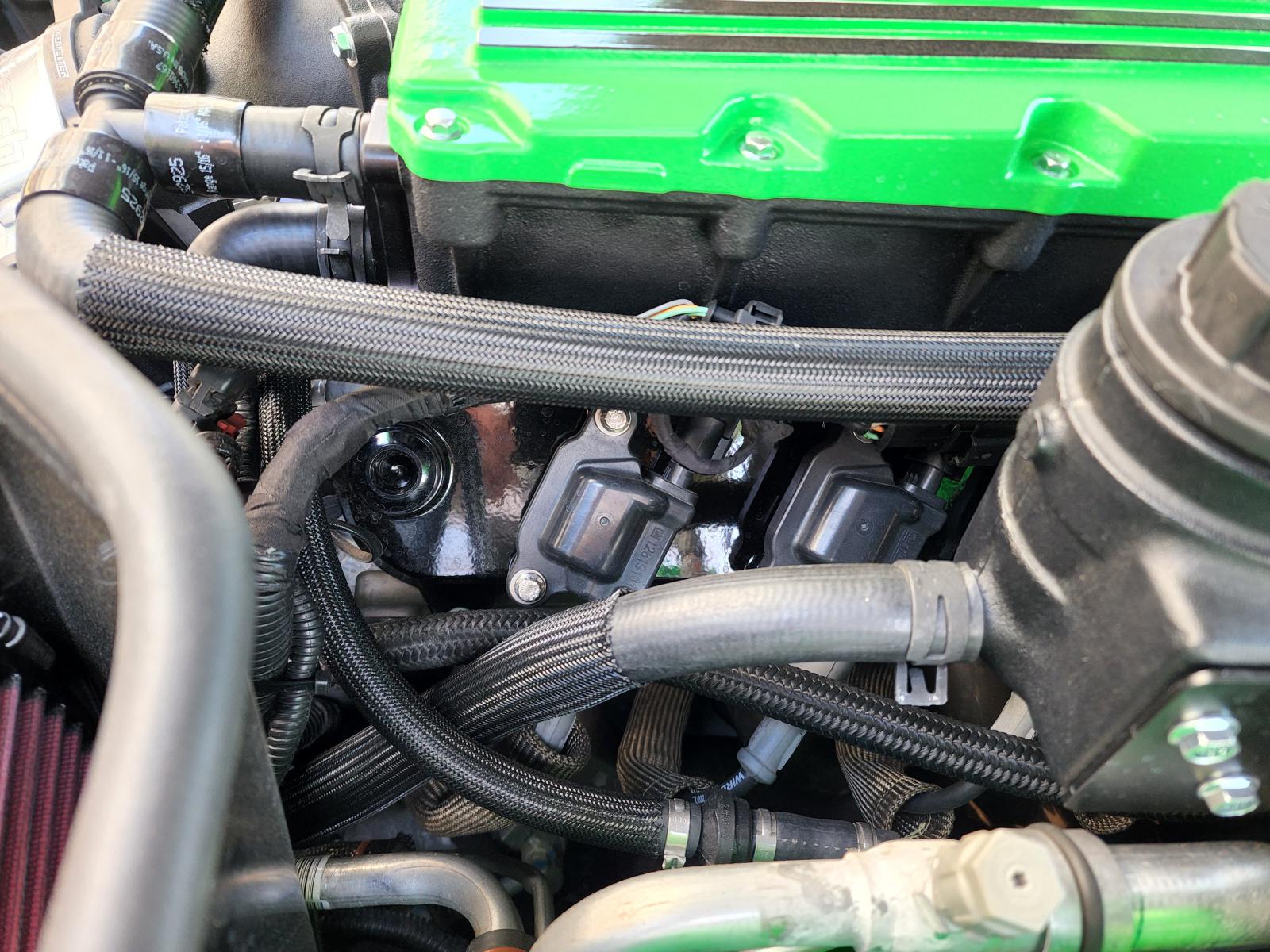

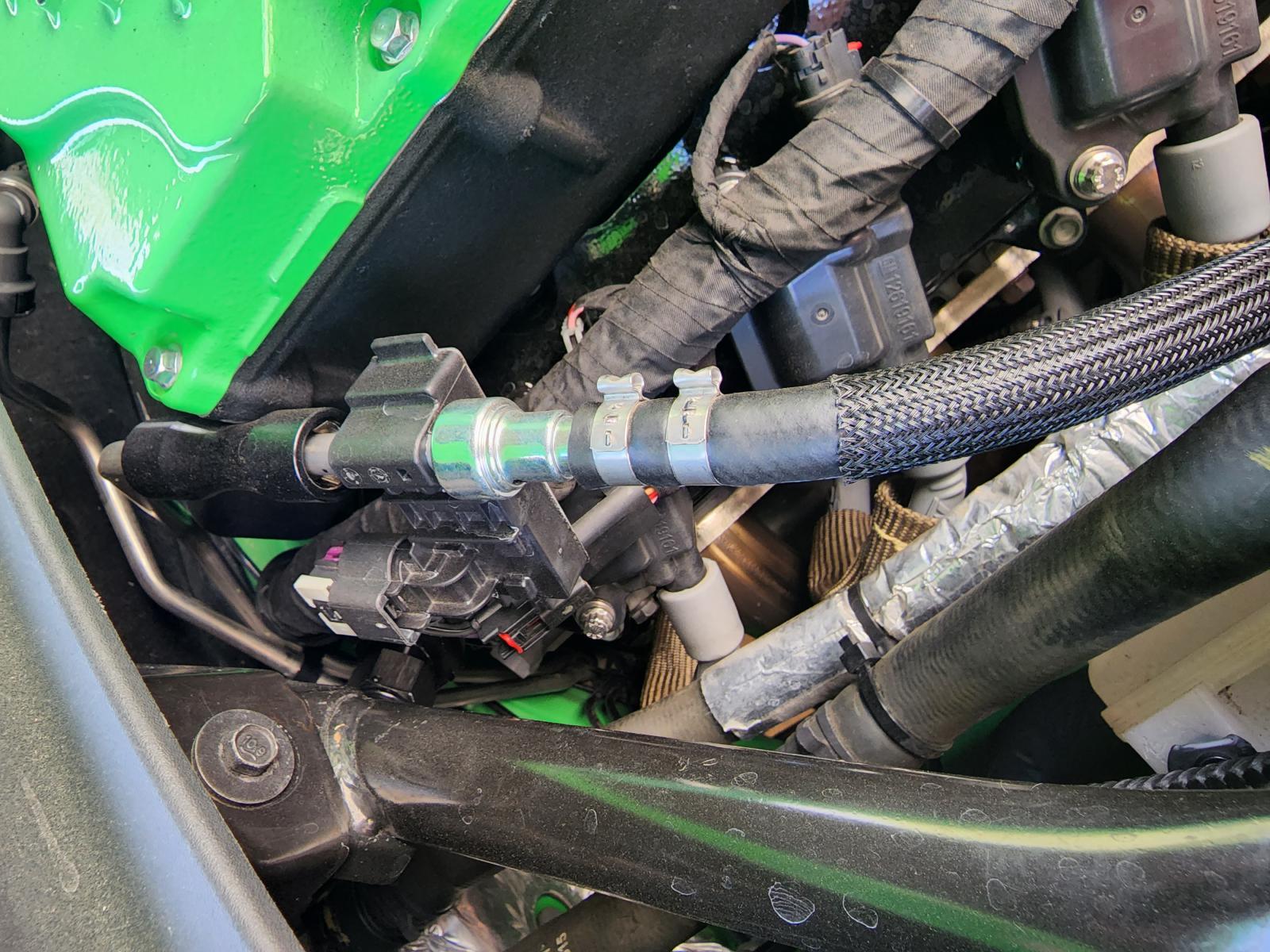

A few questions if you don't mind, where did you tuck away the flex fuel sensor? Is that it near the cowl between the coolant tank and the supercharger lid?
Also, the big gulp looks a bit farther away from the air inlet than I'd expect, did you customize it in any way?
Let me preface by explaining that I did not do the install myself. I had a local shop (StangKlr @ Killer Performance) do the work for me.
The flex fuel sensor ended up near the support bracket on the passenger side. It might be easier to see in this photo taken during installation.
There is a small TB adapter between the 103mm Katech and the 90mm supercharger snout. My goal is to swap in a proper 103mm snout when we change the pulley ratio so that both can be incorporated into the next tune.
