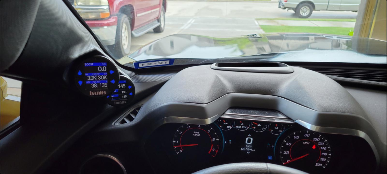

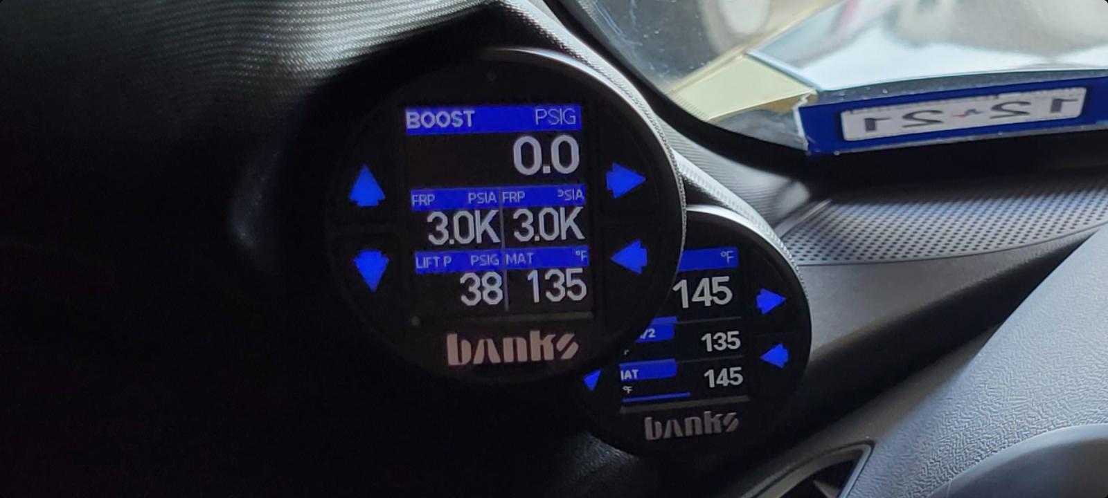

Can anyone tell me what the 3 IATs represent and where there measured on a boosted camaro SS I installed the Banks Idash guages and ZZ pod and just want get them correctly labeled.
Logically
IAT 1 would be some where near the air inlet of the air filter.
IAT 2 maybe by the MAF or by the TB somewhere
IAT 3 Map sensor
They all 3 read on my guages

It's an old thread but I am posting this here as well for those trying to set the right parameters to follow on their gauges:
IAT1 = Temperature measured at the MAF sensor (real data)
IAT2 = There is no IAT2 sensor, it is a calculated value derived from ECT and IAT1 (not real data)
IAT3 = MAT (real data) - PID used for blower temperatures
So it seems that it makes sense to monitor IAT1 and IAT3 (MAT). I don't see any use of monitoring IAT2, unless I am missing something.
