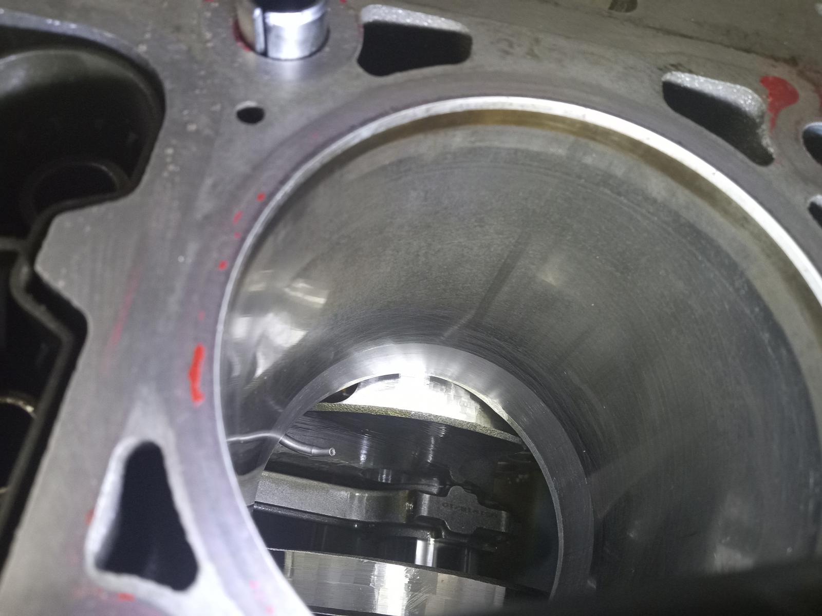

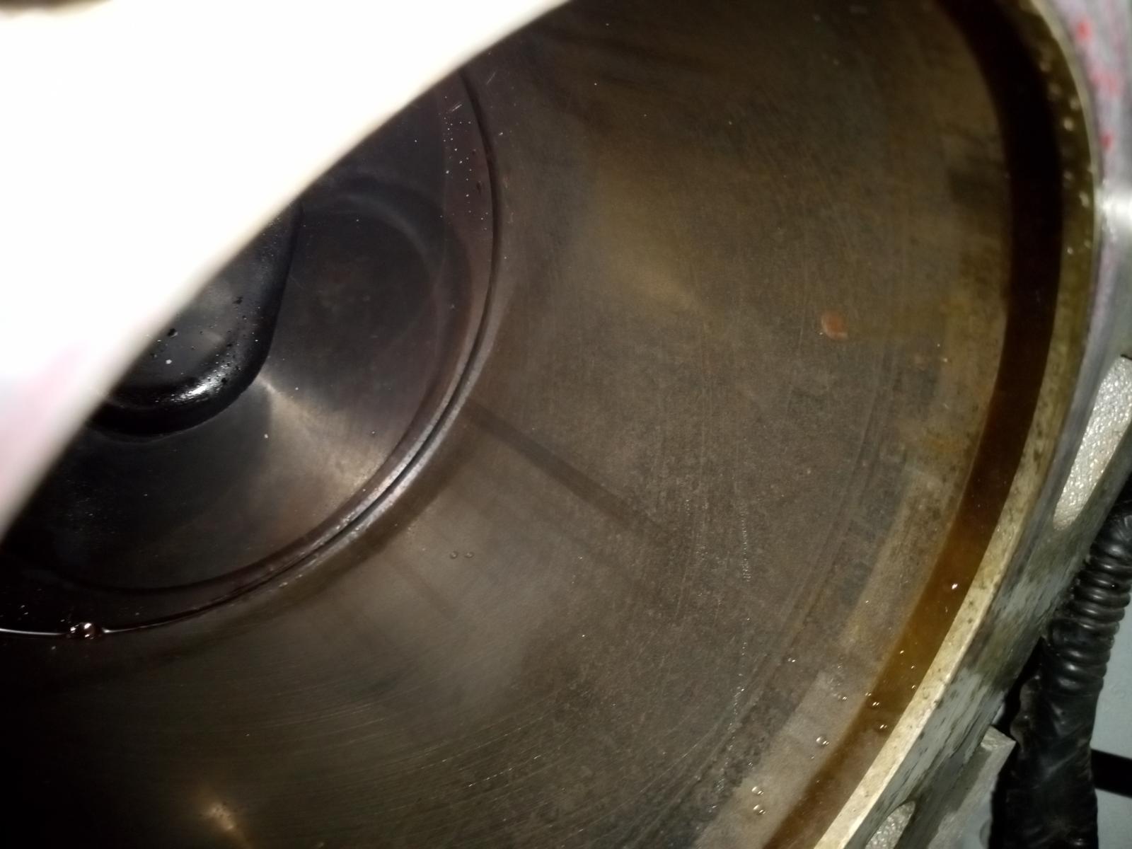

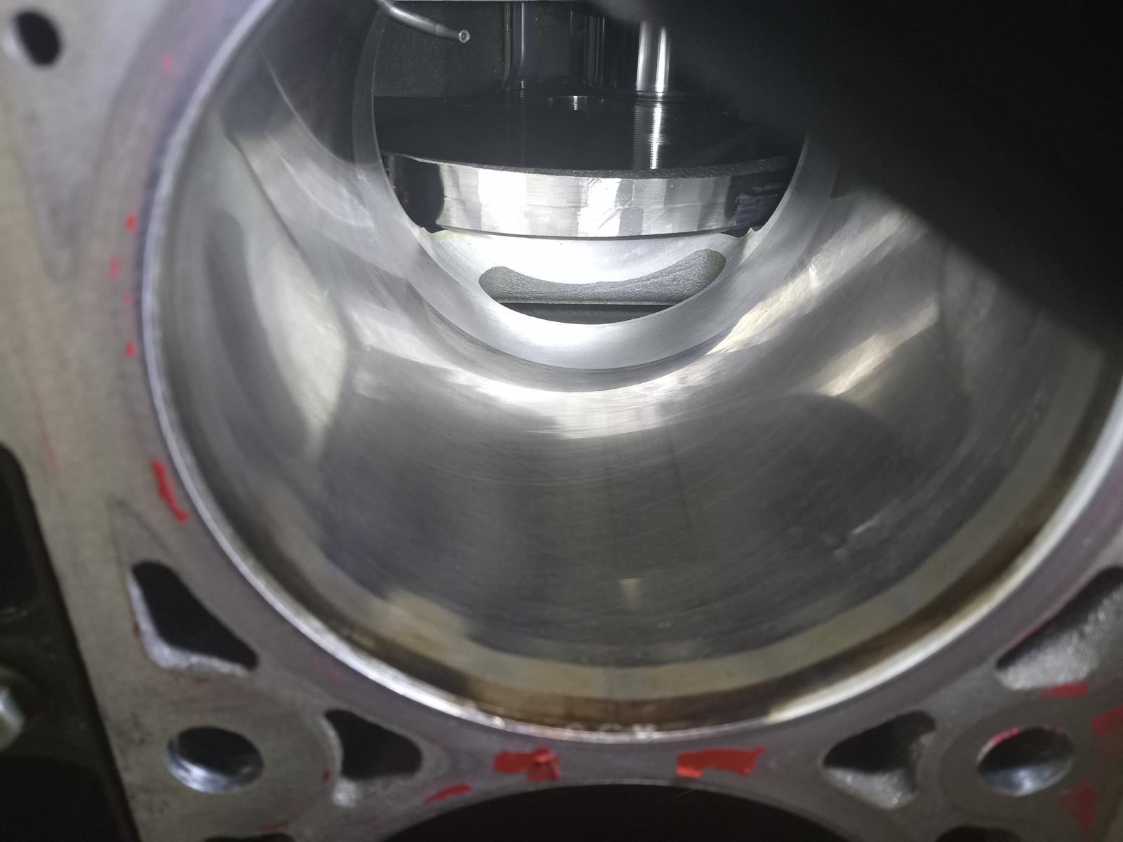

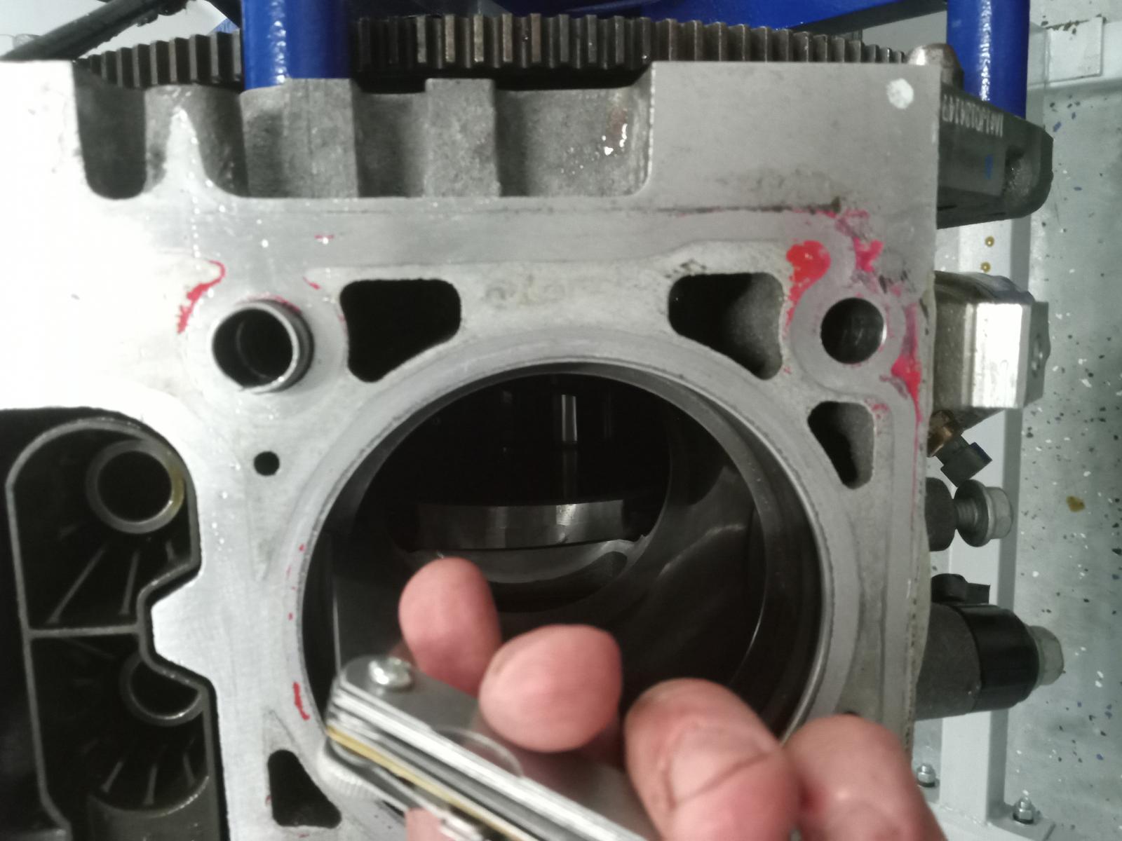

Hard to tell from the pics.. the first one is kinda blurry and the second one there appears to be pits and little metal chunks.
Are there pits in the crown and/or the head chamber?

Originally Posted by Crazy Drywall Guy View Post
Looks like no major cylinder damage,can't even feel it. Bank 4 on driver's side is the only cylinder that fail leak down test.
Now u have found the real problem!! Glad u got it before any major damage.
It not pits,it's little drops of antifreeze. It's the back cylinder so it's almost impossible to take a good picture,but if you look close there are darker vertical streaks on the cylinder wall.

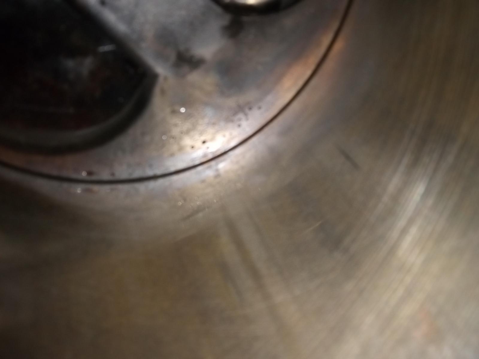

Pics are awesome and thanks for the clarification. It's hard to get to those back cylinders.
Pull the piston and maybe you can get a better pic.
On both I see the bore marks, but the first one is blurry, and it looks like that area on the piston crown by those bore marks is pocked. Hard to make out what's up in the second pic (piston wise).
On the other side of the coin, if you did lean out, that would/could cause seizing.
The skirt and crown to the first ring will have more clues as to what happened too.

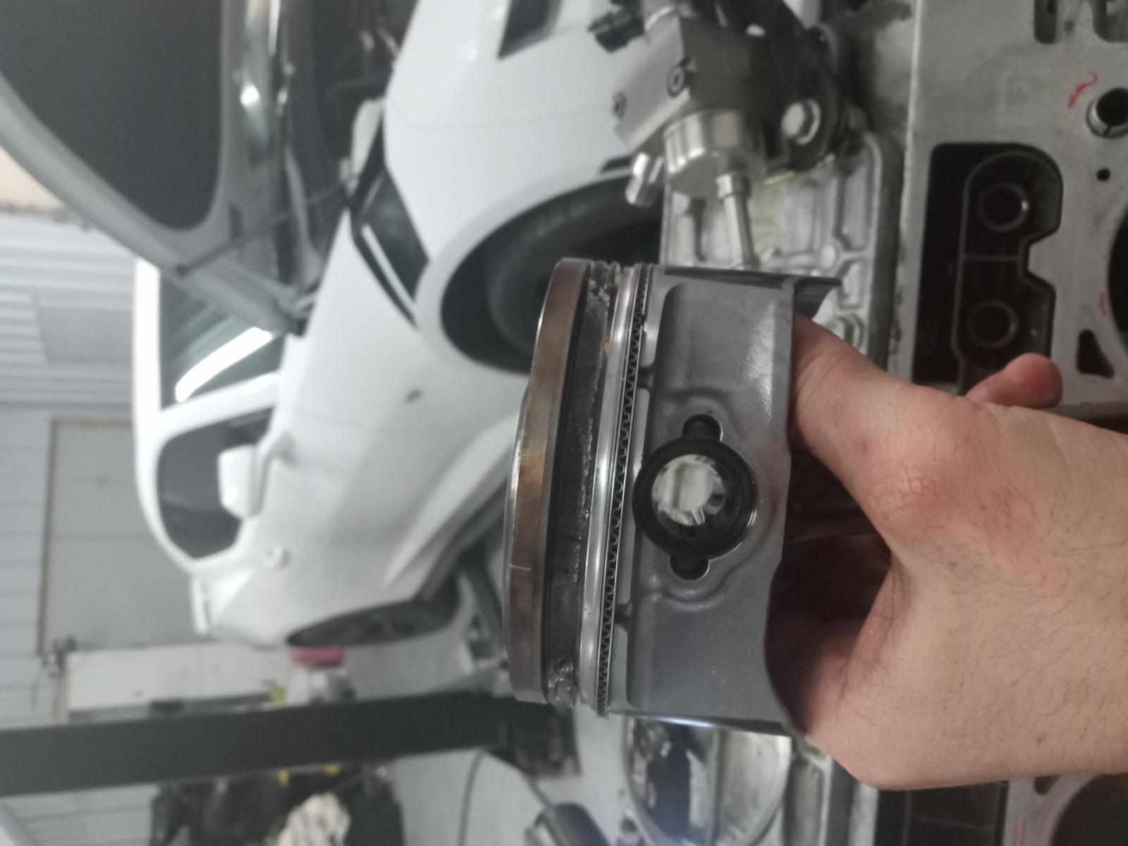

Crank looks good ,but looks like the bearings took a hit

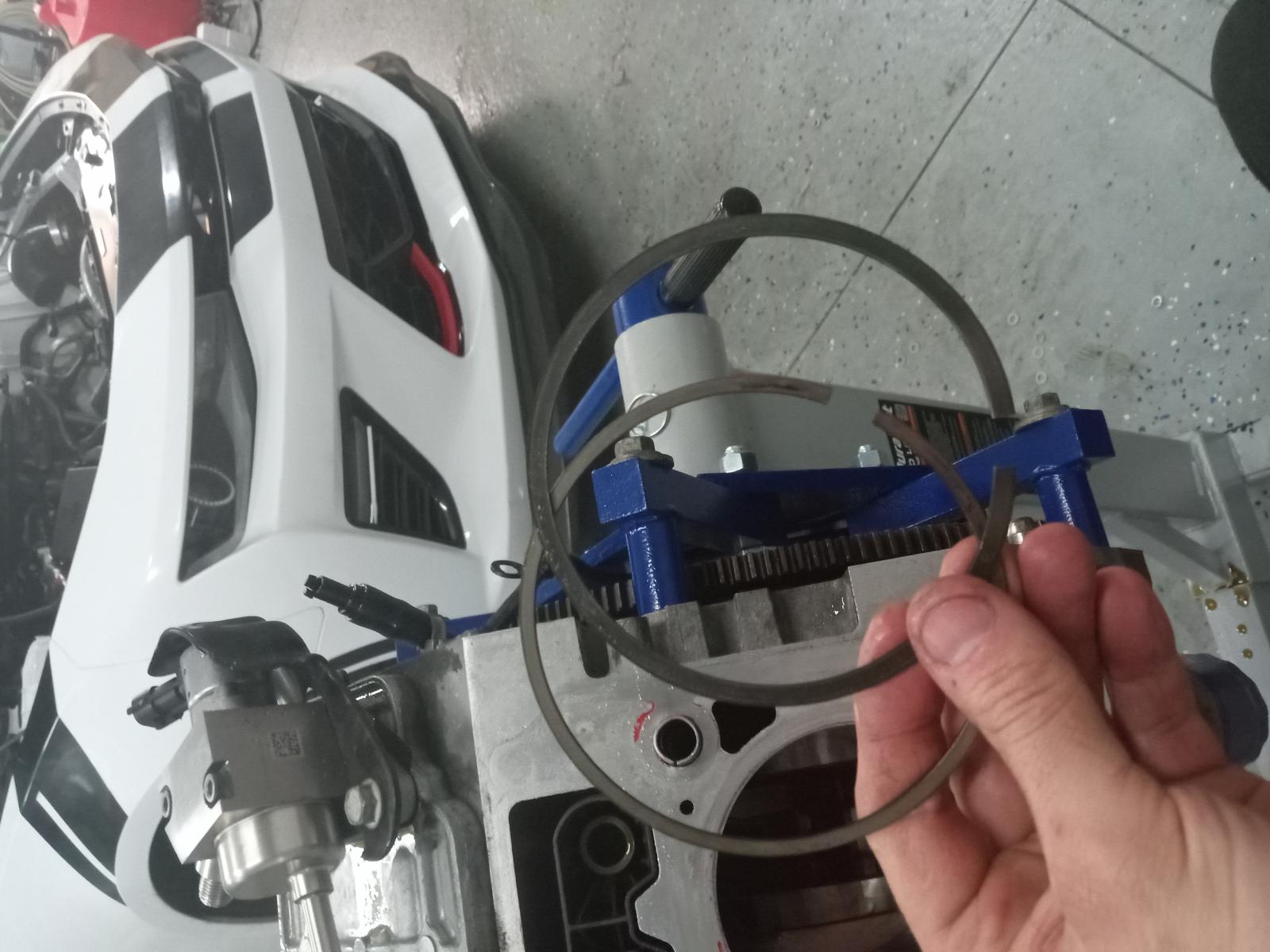

Any luck finding the piece/pieces of piston missing?
Old 03-12-2022, 06:07 PM   #55
Crazy Drywall Guy
Drives: 2018 Chevy Camaro 1ss
Join Date: Nov 2020
Location: Clare MICHIGAN
Posts: 62
Yes,they were still on the piston until I pulled it out of the cylinder.
