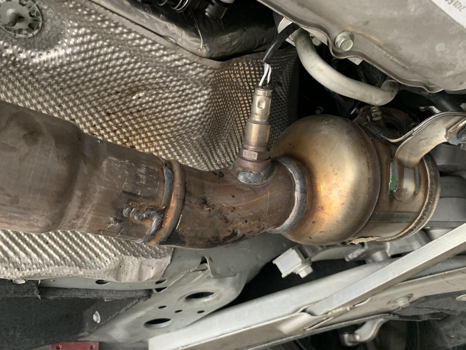

I am not sure if this helps but I had a similar experience tracking my ZL1 at COTA. I arrived with close to 3/4 tank of fuel and had to fill up 2 more times for 5 20-minute sessions. I also have the AWE touring (no resonators). My reflectors on my diffuser disintegrated after the second session. The license plate lights went from flat to drooping. the Chevrolet emblem on the trunk was deformed and both taillights have signs of warpage. 1 day after the track day my engine check light came on indicating an issue on bank 1 (Catalyst System below threshold Bank 1). The dealer tried to address the issue 3 times. 1- replaced O2 senser, 2- Replaced Cat, 3- replaced clamp to cat (all bank 1). Every time I got my car back the problem returned within 5 miles of driving. I took it to a local muffler shop and had the exhaust to cat welded. No more engine check light since. To be safe I also moved the 4'5" exhaust tips as far aft as possible. All melted parts have been replaced. I have not been back to the track since but hoping for a better outcome next time.

Sounds 90% the same. When you say you had the exhaust welded at the cat, please provide details. Also, has your repair mitigated the heat issue?

Hi JM,
See pictures. In my earlier post I stated I have not taken the car back to the track since so I am not sure if my repair to the exhaust plus adjustment of the AWE exhaust tips aft addressed the problem yet. (FYI: The exhaust tips were installed flush with the aft edge of the diffuser before moving them as far aft as possible.) The exhaust tips are now aprox, 2.5 inches aft of the diffuser.Name:  Cat1.jpg

Diamond,
Thanks for the pics. Understand. Please reach out if possible once you get a good track day.
