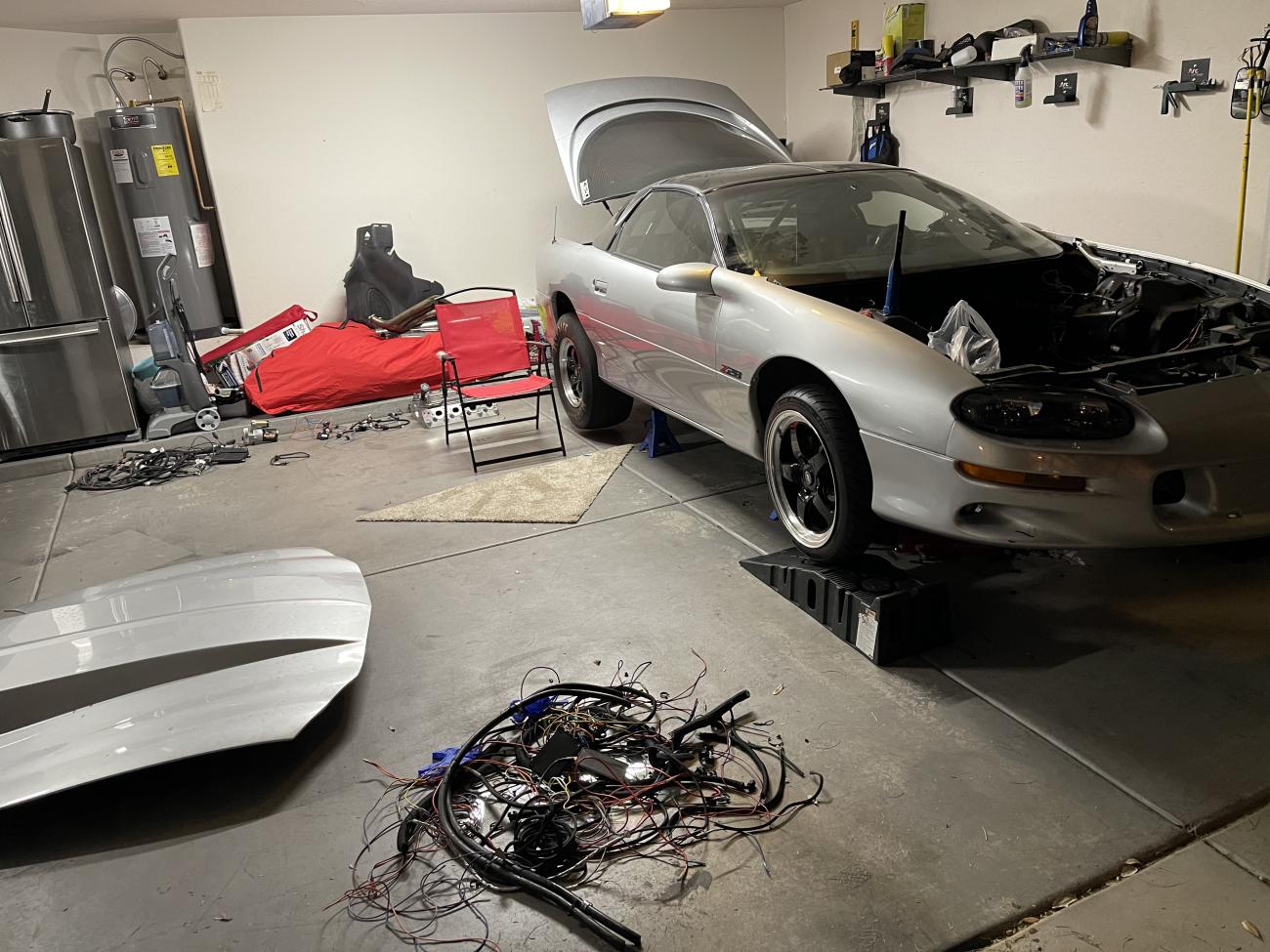

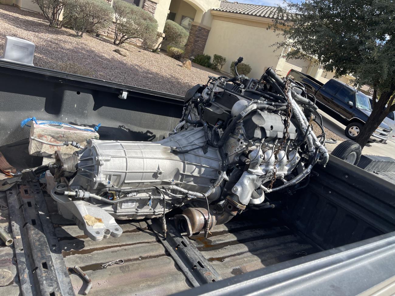

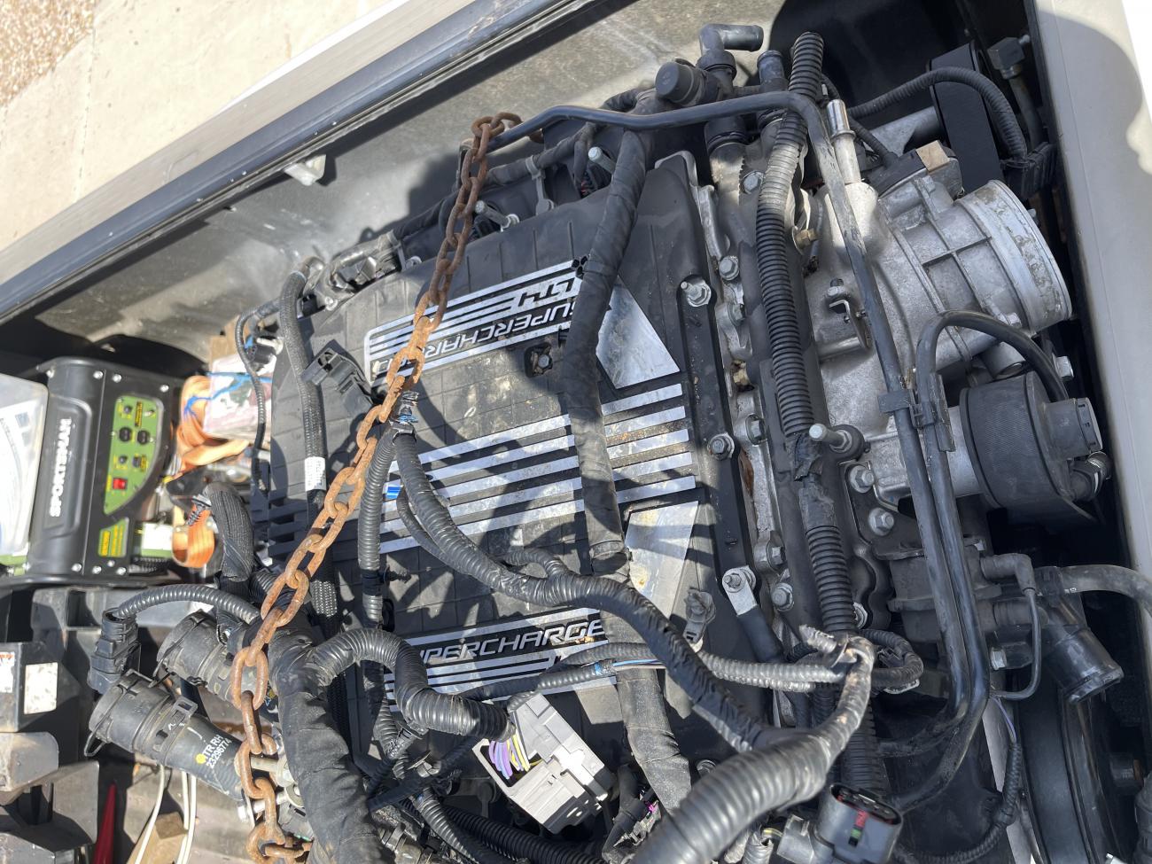

Hello everyone I’m doing a LT4/8L90 swap into a 98 F-Body Z/28
We plan to make it 98% dig race car sometimes roll race.
I’m not very familiar with LT mods I’m coming from an 408 stroker LS
Could use some help we want to do a Max Effort stock blower
What do I need to get to max effort
Plan on keeping factory heads

I’d port the blower (Kong X port) and the heads. Get a cam and valve train to support it. Big investment in fuel system: either large DI injectors and HPFP or port injection. Both options need a bigger low pressure fuel system too.
