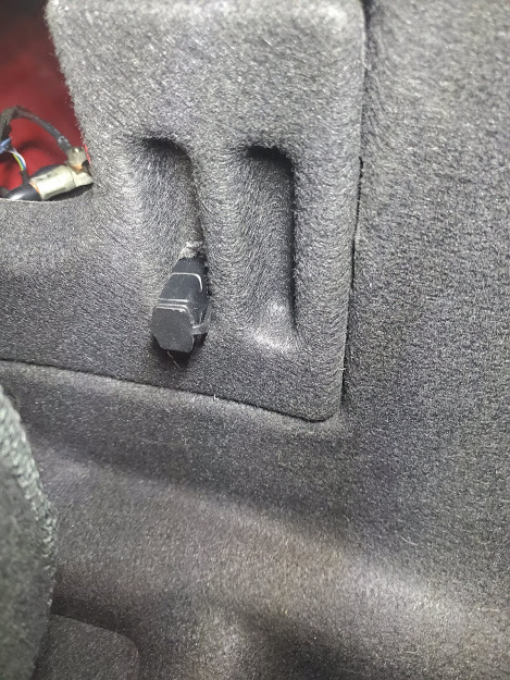

I connected my charger leads to the battery then ran the cord through a small hole I made in the panel, this way I can pull it out when using charger and push it back in so only the cover shows when not in use
