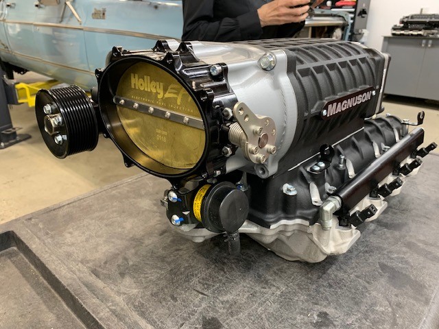

It's actually a 170mm Holley Pro-Stock Throttle body that I made an adaptor for to use on a 2650. Goal was to be able to reach the max flow capacity of the 2650 (not to mention it looks pretty cool), then when Don built that car with a 2650 it seemed like a good application for it...
Attachment 1090158
Hum, guess he moved up the food chain since I saw it last time.
Attachment 1090158
That's the version I think I saw in the video I was referencing.
