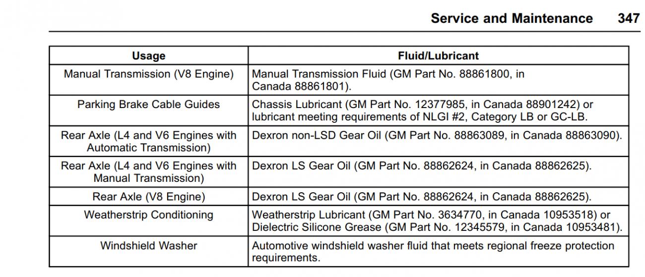

Capacity is different than the ELSD i noted on my 22 vert, 10-4034 ac delco, use pump that goes on quart container with hose and makes it simple on a lift with car level, very simular to change on my two ss sedan's, looks hard but not bad.

The ZL1 vert has the same LSD as the SS (non-1LE, with a 2.77 gear). So it uses the same gear oil:
https://www.amazon.com/gp/product/B008BZS6J8
