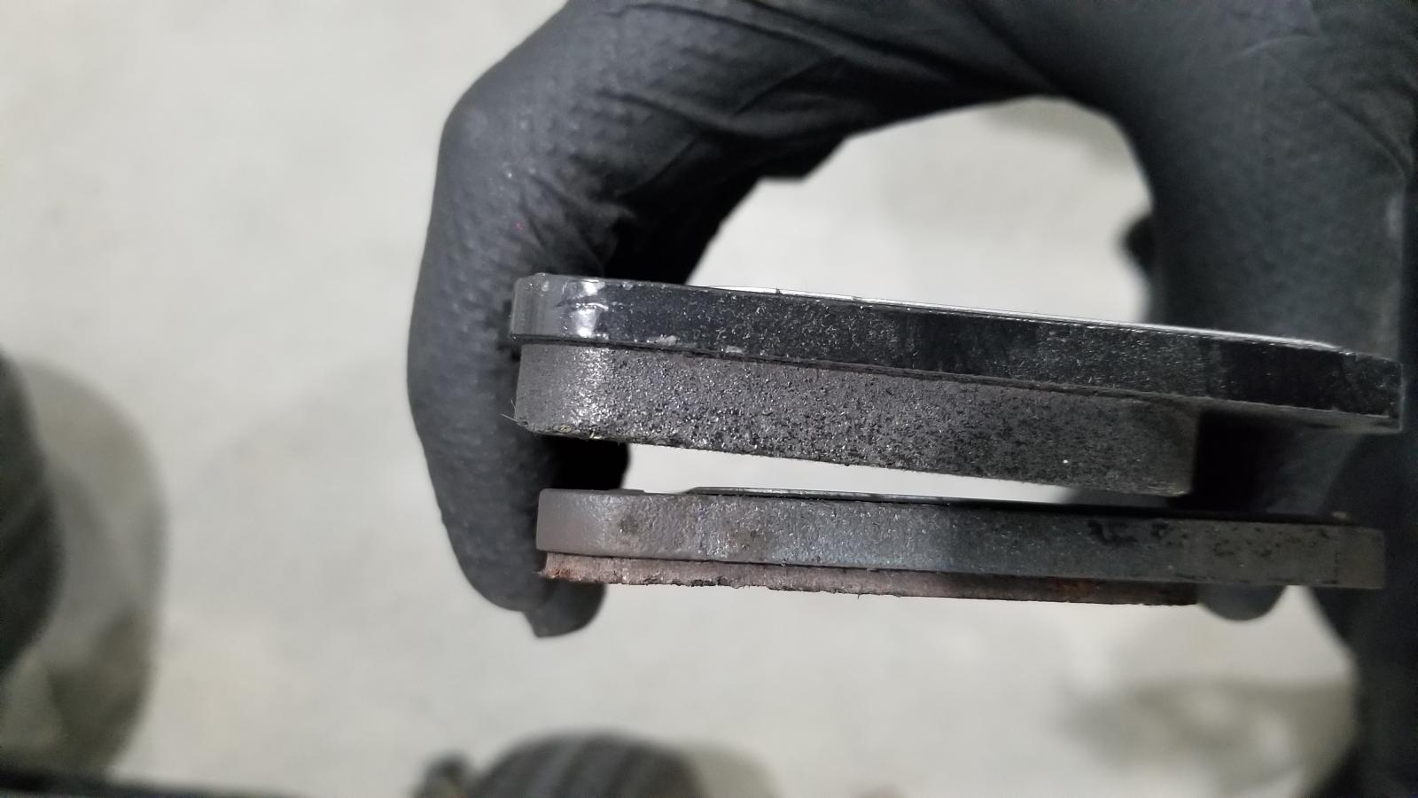

If you got 15K out of the stock pads I must be doing something wrong lol (maybe you were just talking rotors) These are my factory pads on the bottom with 2500miles on them and my new factory pads on the top.

Looks like SFV1LE was talking rotors: "The original rotors have held up over all these track days, I'm amazed. Must be over 20 track days, I lost track--15k total miles street + track."

Yes I was talking about the long rotor life not pads, OEM pads seem to wear as expected when you use them on track. Not bad wear either IMO, and they're quiet on street while DS 1.11 are not, but as I said the OEMs wear much faster than DS 1.11 which have unusually long life.
