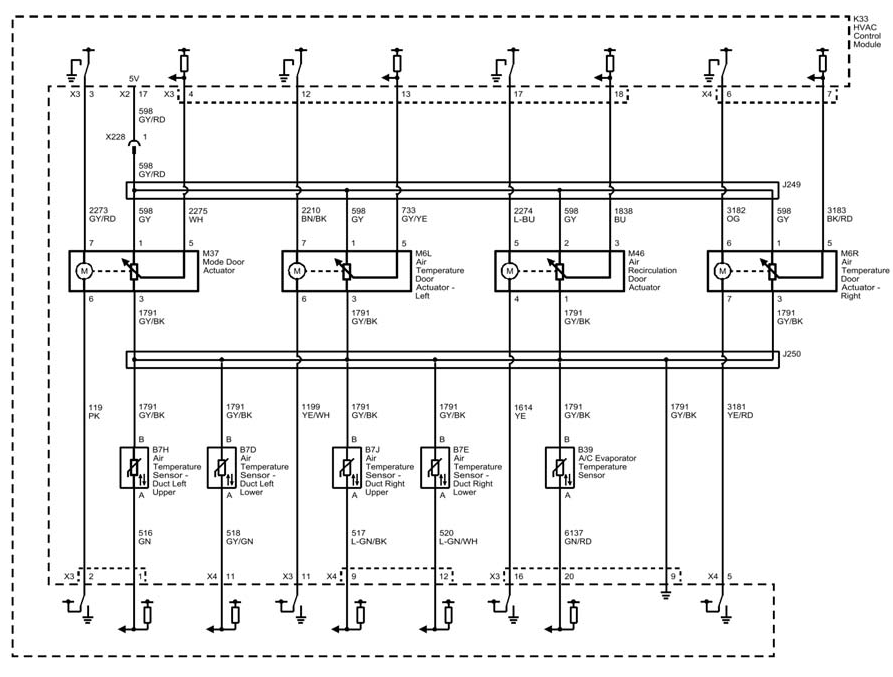

I also uploaded this schematic which shows the number of sensors and actuators involved:

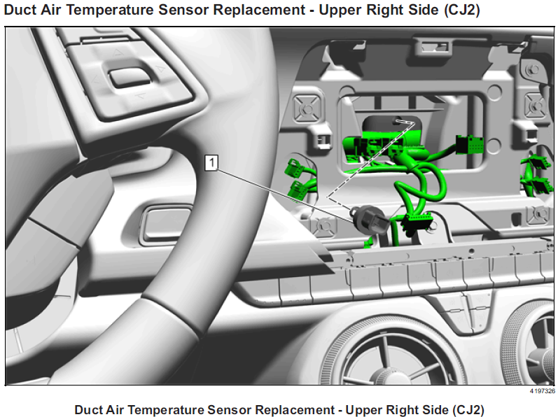

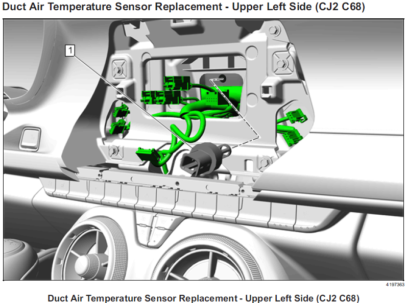

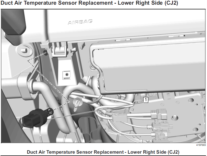

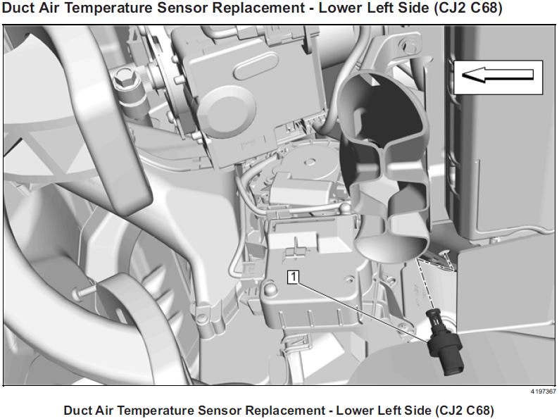

The duct temperature sensors (22801046) are installed in the air distribution ducts and measure the temperature of the air that streams from the ducts. The HVAC control module uses these values to adjust the mixed air door position according to the requested temperature.
RPO CJ2 dual climate systems have two of them located behind the Radio Control Assembly and the other two are located under the dash up stream of the floor outlets.
RPO C68 single climate systems have one of them located behind the Radio Control Assembly and the other one is located under the dash on the left side up stream of the driver side floor outlet.
You will need a quality ODB2 scan tool and not a code reader to determine which sensor is not reading the correct temperature prior to replacement. They are a pain to remove if you do not have a forked pry tool and be careful not to drop the upper sensor inside the dash.

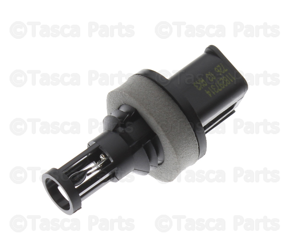

Nice detailed info, SSgt!
Looks like those sensors have a Christmas tree type base.
I would invest in the pry tool (or a cheap set from Harbor Freight) to dig these out. Might want to put some masking take on the back end before you pry to give it a tail in case it goes flying.

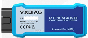

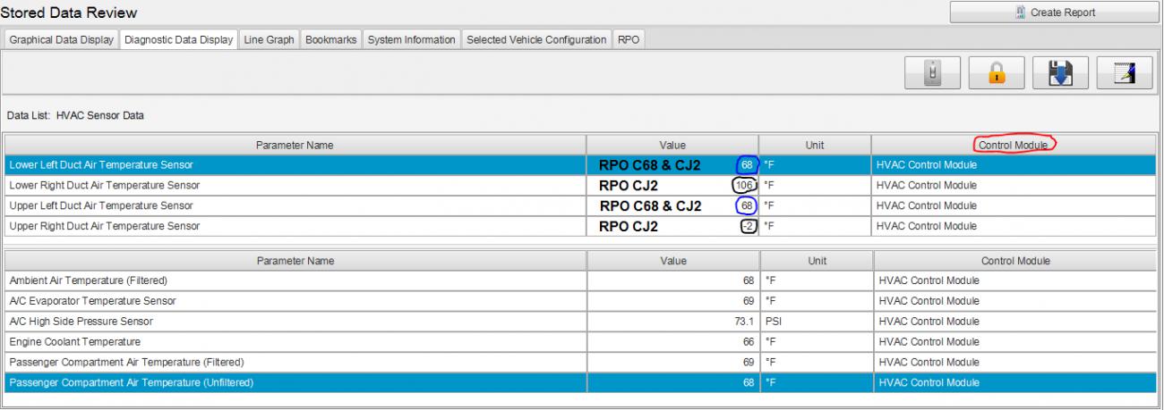

VCX Nano GM
If you know your way around a personal computer, then you might try VXDiag VCX NANO Diagnostic Tool for GM. It uses GM Global Diagnostic System 2 (GDS2) software with their version of a GM Multiple Diagnostic Interface (MDI) Tool to make the GM GDS2 software work.
Warning: it comes from Mainland China and will cause problems with virus protection (add exclusion for each file it finds), so use on a laptop dedicated as a scan tool only. Also, search YouTube for multiple videos on the VCX Nano GM.

Camaro with C68 Single Climate System, HVAC Control Module Example Data:
Note 1: Vehicles with C68 installed will show very high and low temperatures for right duct air temperature sensors.
Note 2: A failed duct air temperature sensor will show very high or low temperatures.

Another scan tool that could be used and not as powerful as the GM GDS2 is AutoEnginuity Giotto Version (acquired by Drew Technologies January 2020) with Enhanced GM-family Expansion.
