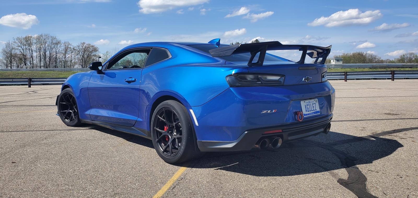

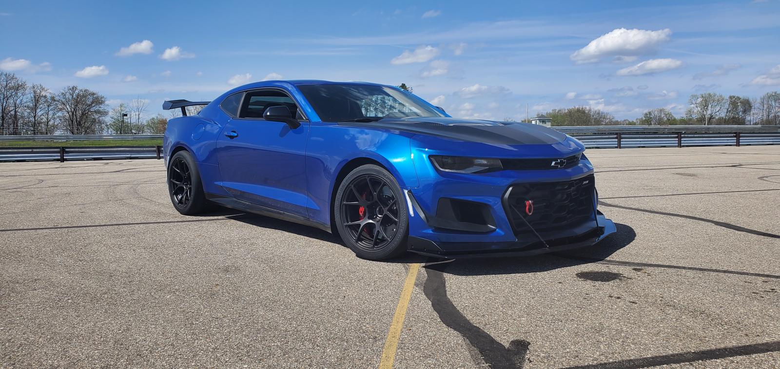

I kept my stock ZLE wheels for street use and run Michelin PS4S. For the track I went with 18's and run Hoosier slicks. I went with a set of BC forged wheels.

That looks great! I like those wheels. I'm going to need a year a so under my belt with the ZLE before I even think about slicks. I'm coming from an SS1LE so I would like to get comfortable with the extra power.
