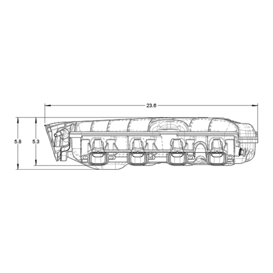

So here are the dimensions of stock, performance design and hi-ram. The pTr intake is shorter. I hope you find this fits under our hoods if you get one.
