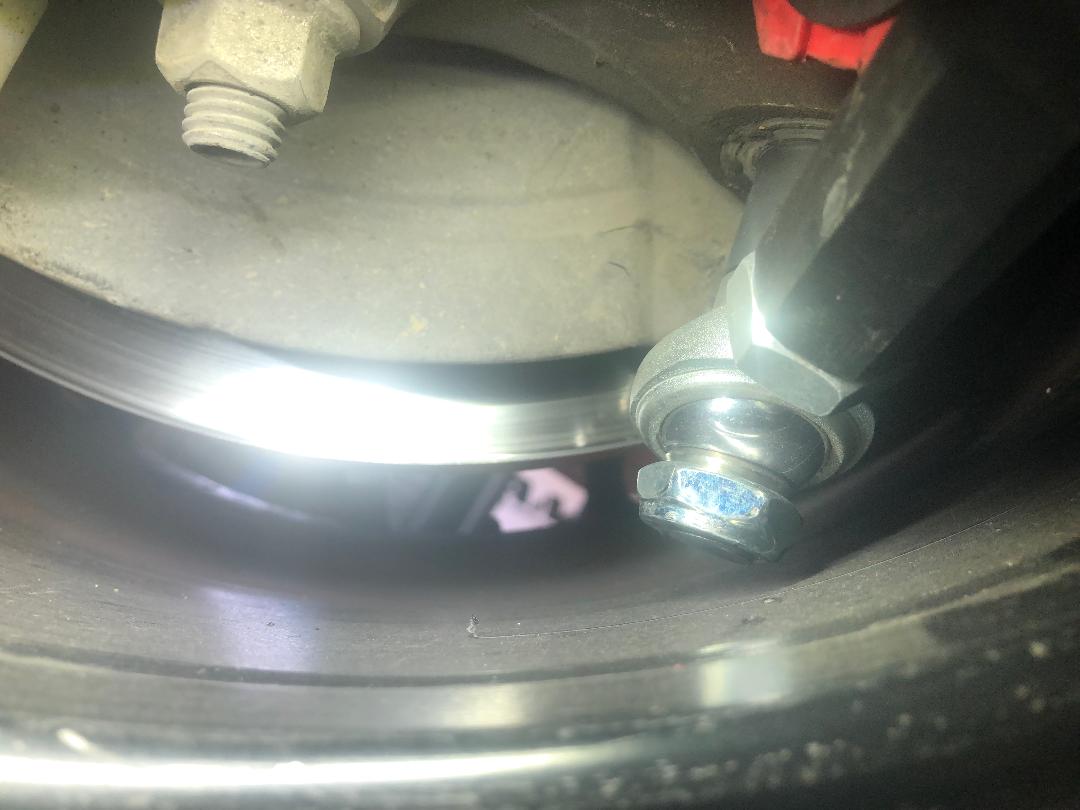

Ok as mentioned there are TWO issues with making this part work with 19 inch and 18 in wheels.
I mentioned in the previous post that SPL PARTS sent me a THINNER center lock nut BUT it still wasnt thin enough to provide proper clearance so I asked AMP to source me out a MUCH thinner NYLOCK nut.
If you are using 19 inch wheels, you can retain the STOCK NYLOCK nut that comes with the bumpsteer kit but you will need to NOT use TWO of the small washers.
The FIRST pic shows you how that looks on my 19 inch wheels with the spacing between the end of the thread and the inside barrel of the wheel. Looks like maybe 1/2 inch clearance. Notice that the thing that is CLOSEST the inside barrel of the wheel is the threads because they protrude slightly thru the NYLOCK nut.

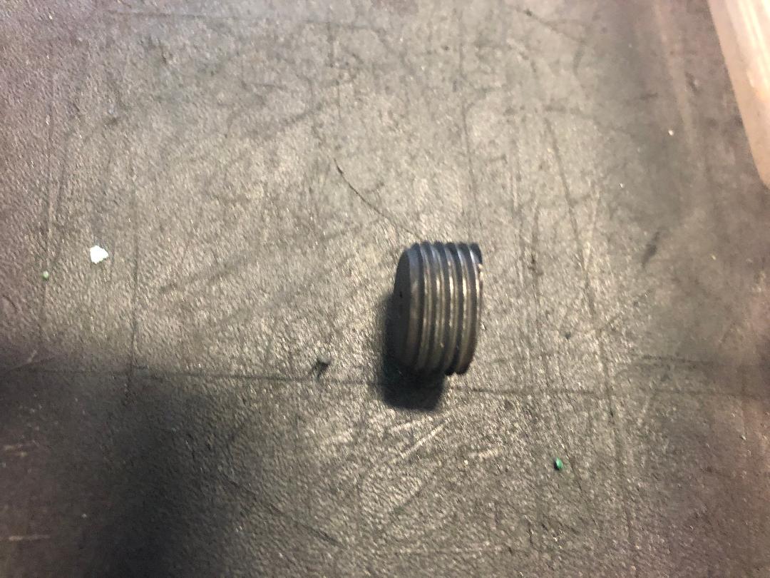

Now if you are using this on an 18 inch wheel, then you will need to BOTH shorten the threaded portion of the bolt AND you will need to use a MUCH thinner NYLOCK nut.
The SECOND picture shows me holding the original NYLOCK nut next to the newly installed THINNER nylock nut. You notice it is about 1/3 the size of the NYLOCK nut that comes with the kit.
The THIRD picture shows about how much of the thread on the bolt was cut off so that it jus BARELY protrudes thru the new THINNER NYLOCK nut.

The FIFTH picture shows the clearance NOW with my 18 inch wheels.
