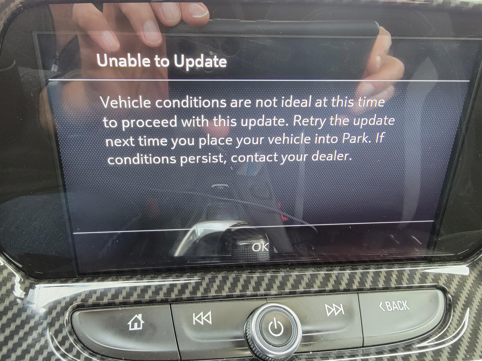

As my camaro is in the dealership for yet again infotainment system issues I had the pleasure of a 2021 Chevy Blazer loaner. I was pretty impressed by the loaner, great on gas, roomy and had more pep then I thought. But I decided to connect my phone using the USB cord and I was surprised it didn't work like in my camaro. As I was trying Bixby kept trying to turn on and it did the same thing in my camaro after the last update on my old phone. So I stated to think could Bixby be interfering with Android Auto? It wasn't easy to disable Bixby but I got it done, so after work I again connected my phone to the USB in the Blazer and it connected immediately. Everything was working as it should. On my way home the dealership call me and told me that the infotainment system is working as it should as they have connected several different phones. When I arrived at the dealership they went through all the steps with me and now everything is working as it should. Could it have been Bixby all along conflicting with Android auto hard to believe?

I agree, to many apps are now pre- loaded on these phones when you get them and many of them can't be uninstalled, but at least they can be disabled. But now when I start my camaro up I use to just connect first thing with my usb cord for Android Auto and everything work now I have to first connect with Bluetooth then the USB cord, I believe it also has something to do with Android Auto last update and it really mess everything up. I believe that the Ford F-150 is having big issues with there Wireless connection and Android Auto is supposed to have a fix coming out in March along with a 6.1 update.

After my 3rd visit to the dealership for infotainment system issues here is what happen. Radio was replace, and even after that the mechanic still couldn't get the system to update. On the invoice it says: system refuses to still update or accept command. Now, Bluetooth works just fine until I connect with the usb-c cord to Android auto to use Google maps and voice to text. With voice to text there is no voice command and Sirius XM no sound unless I switch back to Bluetooth and play a song from YouTube then switch back to Sirius XM then the sound is back on. Service manager told me everything is working as it should and that other phones where connected and no problems but I never witness it. Does anyone know of a good stereo shop or someplace that's Specializes with these problems that are located in Pittsburgh. I keep getting told by others that the update takes time but it's been over a month. Getting frustrated with this thinking about the lemon law.
