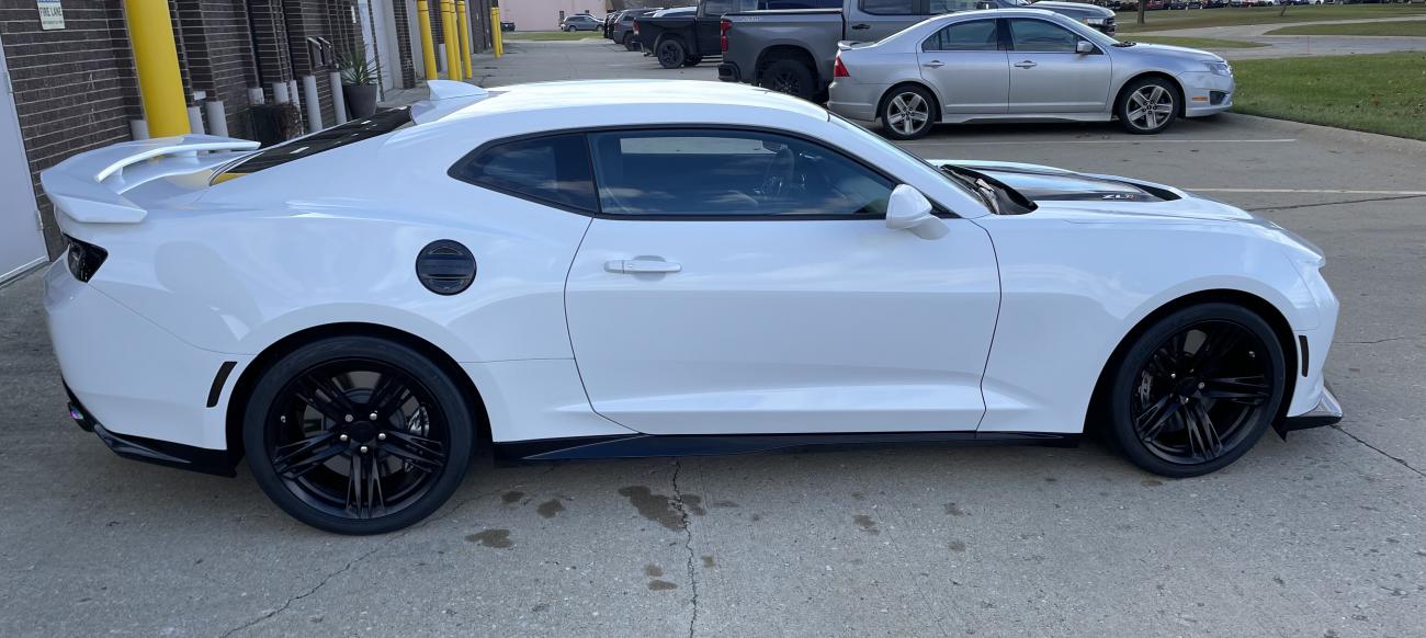

Here are some photos of the ZLE wheel/tire on my standard ZL1. Camber and toe set to track. No poke up front. Will see how things go next spring before deciding on camber plates.
