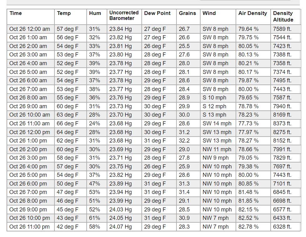

HP Correction Factor
Take a shot at correcting hp to sea level with this!
It's actually pretty good for here.

It made 730 actual on 100 oct., and, using a 15% correction, which would be the lowest anyone up here would ever use, that's 840 wheel. My tuner used a higher correction, but, again, dyno software does not actually correct, in my case, 7,000 ft to 0 ft. Probably could do a little better with E and less 100.
Most racers up here use 20%.

Just got off the phone with Madcap Racing Engines, Lakewood, CO, Phone: (303) 298-0044 who said they used a CF of 27-32% last week.
I've got an email into a few dyno shops here and will post their CF when I hear back.
However, it's important to remember that different makes of dynos will record different power numbers for the same car/engine. By way of example, DynoJets in the same town will report different numbers for the same car/engine also.
Track times are really all that matter.
