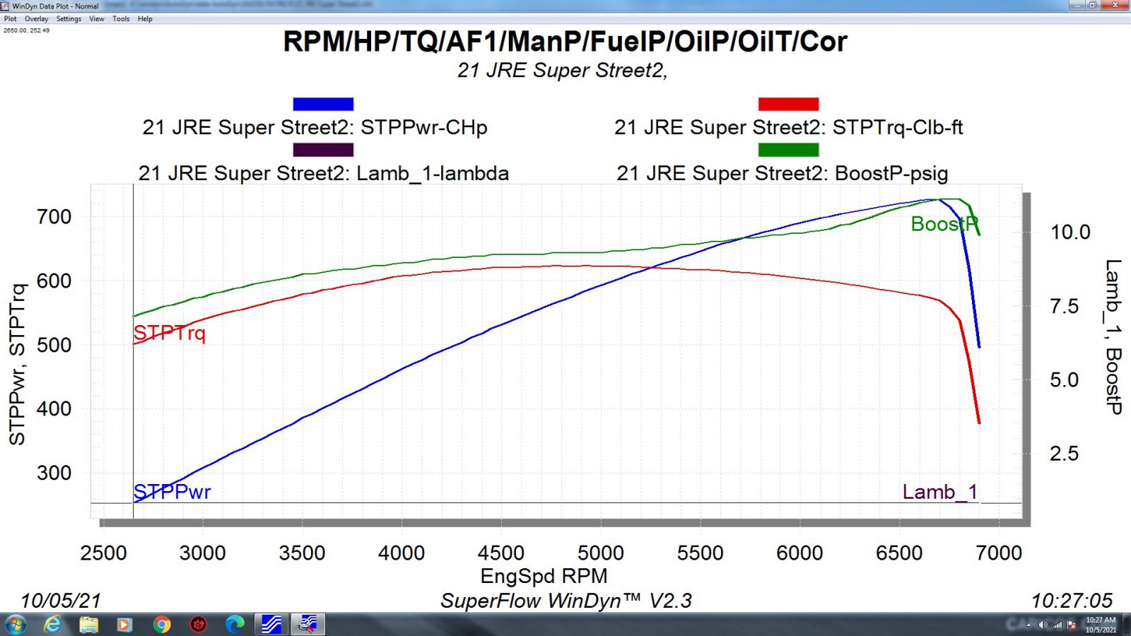

Team JRE just finished a 2018 Camaro SS 1LE for a local customer, with our JRE 2650 Terminator package.
Stock LT1 long block.
Rotofab
LT5 TB conversion
Magnuson TVS 2650 9,17 lower 110mm/4.33 inch upper
JRE rough Idle Terminator cam package
Kooks 1 7/8 LT Ceramic coated, with Green catted x pipe to stock muffler.
LT4 HPFP, LT4 Injectors, JMS fuel system voltage booster
NGK LTR7IX plugs and MSD wires
JRE custom tuning via HPtuners.
93 octane pump gas purchased locally.
Results, 726 RWHP, 622 RWTQ.
Questions or comments are welcome.
