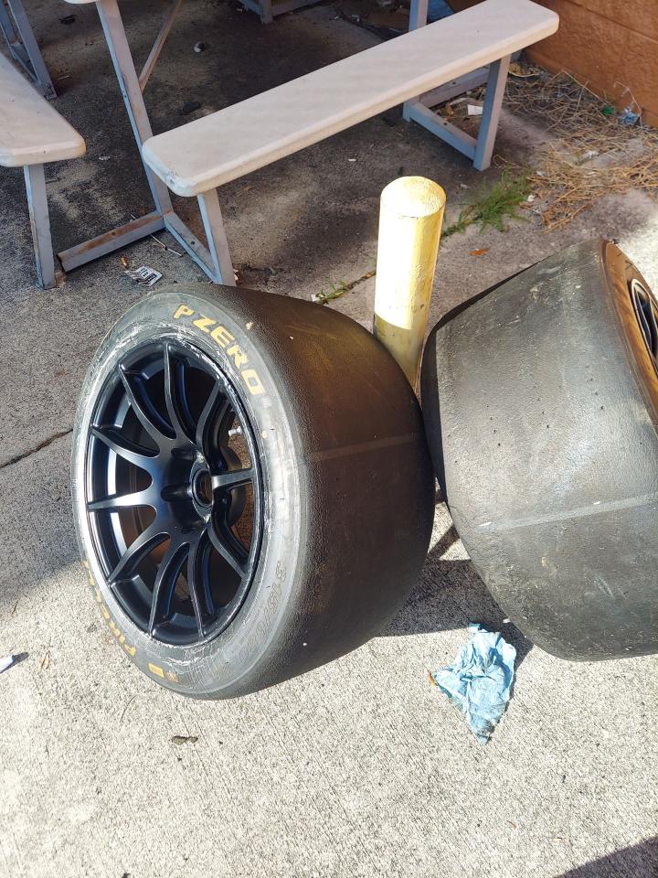

I run apex direct fit 18x11 and 18x12 with pirelli DHB slicks, size 305 660 and 315 680. I could probably get away with 325 680 for the rear with harness relocation. No rub and handles amazing.
