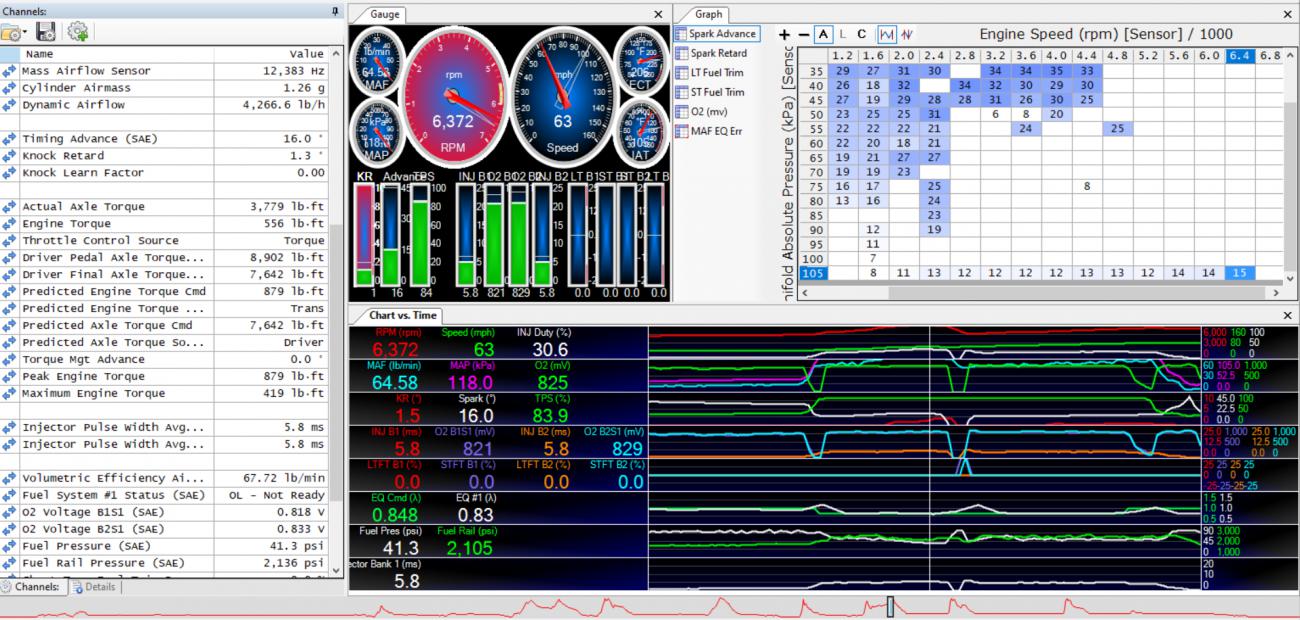

Ok... big temperature change between Monday and today, so hard to compare seat of the pants feel. Obviously feels much more powerful today at 64 deg F instead of 88 degrees, so not quite an apples to apples comparison.
Updated the enable torque tables. PE is now occurring throughout the full RPM range at WOT... or 70% and higher...
Couple of things. Inj pulse width ms is around 5.8 AND there's still some knock retard in the upper rpm range.
Looking for input on how to approach.
Option #1 - Increase PE for that range... try to get closer to .82 lamda. With inj pw already at 5.8... not sure how much further I can push that.
Option #2 - Pull timing from the base table at those rpms/load.
My thoughts... since I'm a noob... start by pulling timing by 2 degrees at those rpms, may actually get more power if I'm already past the peak supportable ign timing? Pulling timing cant hurt at least. It's safe.
After the above, verify if KR goes away.
If yes, then maybe modify the PE tables to increase enrichment by a small amount... maybe .5%??? Not sure what the effective relationship is between a .5% or 1% increase to the PE tables will have on injector PW. My understanding is that above 5ms is "a lot", but could maybe push to 6.2 ms if the SOI is already adjusted (based on input I've received)
Procharger modified the SOI, but not sure if it was modified enough to support 6.2ms inj pulse width.
So... asking myself, what am I trying to get out of this right now???? I think I need to be happy with the power level, whatever it is at WOT until I upgrade fueling.
I want to change a few things so its safe, but effective. Feel like I'm close. With the Knock Retard showing its ugly head, I'm probably at the limit for timing at WOT. Earlier in the thread it was mentioned to zero out the static retard. This was done in the canned tune, so we are good there. I have to think its real knock, and dangerous.
Other than that, would like to "brighten up" the part throttle feel. Thinking I might be able to do that with some small timing experimentation in the part throttle ranges.
Attached a shot of a section of the log. LMK if anyone is interested in seeing/knowing more. My goal is to help others in the same situation.

Try to keep injector PW to under 6.0 ms. Don't go by duty cycle. You should be shooting for .82 lambda anyway IMO.
What are you commanding for low pressure at WOT? 41 psi looks low IMO.
If you have access to Boostane or higher octane gas, put some in and take another log. If it goes away it's probably real. If not, most likely false knock if you're commanding 16 degrees.

Turn the timing back to 12 degrees, get the fueling sorted, then creep the timing back in.
I know on my buddies P1x car it will only tolerate 12-13degrees on 93. It has full LT4 fuel system and making 7psi average and 9.5psi peak at 6500rpm.

Ah, you are right. I did set the timing back by 5 degrees to do the MAF, and then once got the MAF correct, set it back to prior.
Then I tackled the PE issue.
It's been said so much that the canned tune is a safe tune! IT IS NOT! I was thinking that surely the canned settings for timing had to already be conservative, but in hindsight, they look rather aggressive. What a weird mix of settings for a supposedly safe tune.
Looking at when the KR comes on, it's right around 15 degrees. So I neglected one of the basics of tuning, which you have reminded me!
I am also getting around 7.2 psi of boost registering on the gauge now. I'm sure the cooler weather helps that, or maybe just engine getting healthier? Not sure boost scales with engine performance like that, or just RPM and temp.
So recap of changes to fix the canned tune so far:
- fixed the MAF scaling
- fixed the PE not applying correctly
Todo:
- Reduce the timing from 16-17 advance at WOT, and will probably end up around 14-15 from what I'm seeing. Manifold Air Temps def play a role in how likely the KR is. I think there is a scaling factor or table for that I can play with. Much worse KR when it was 88 ambient w/ 130-150 MAT. With 70 ambient and 110-120 MAT, much less KR.
- Try to get PE lambda down to .825 or even .800 without exceeding 6 ms inj pulse width.
