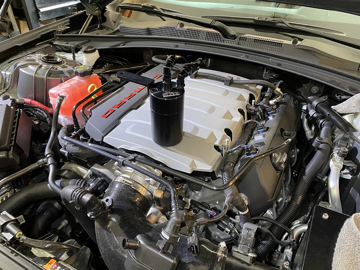

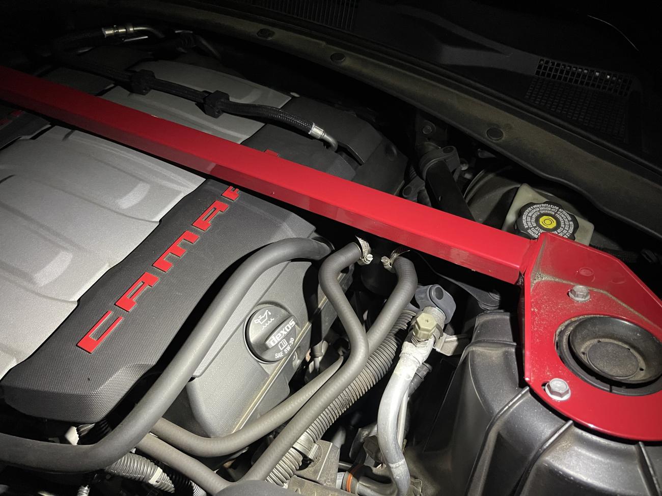

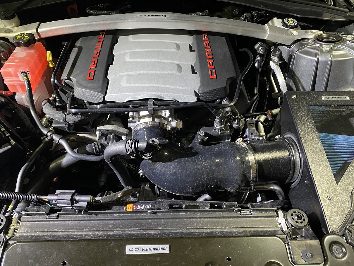

I have the Mishimoto Catch Can and GM Performance Strut brace and both work fine together (I was worried about the same, but no issue...)
You can see them both below...

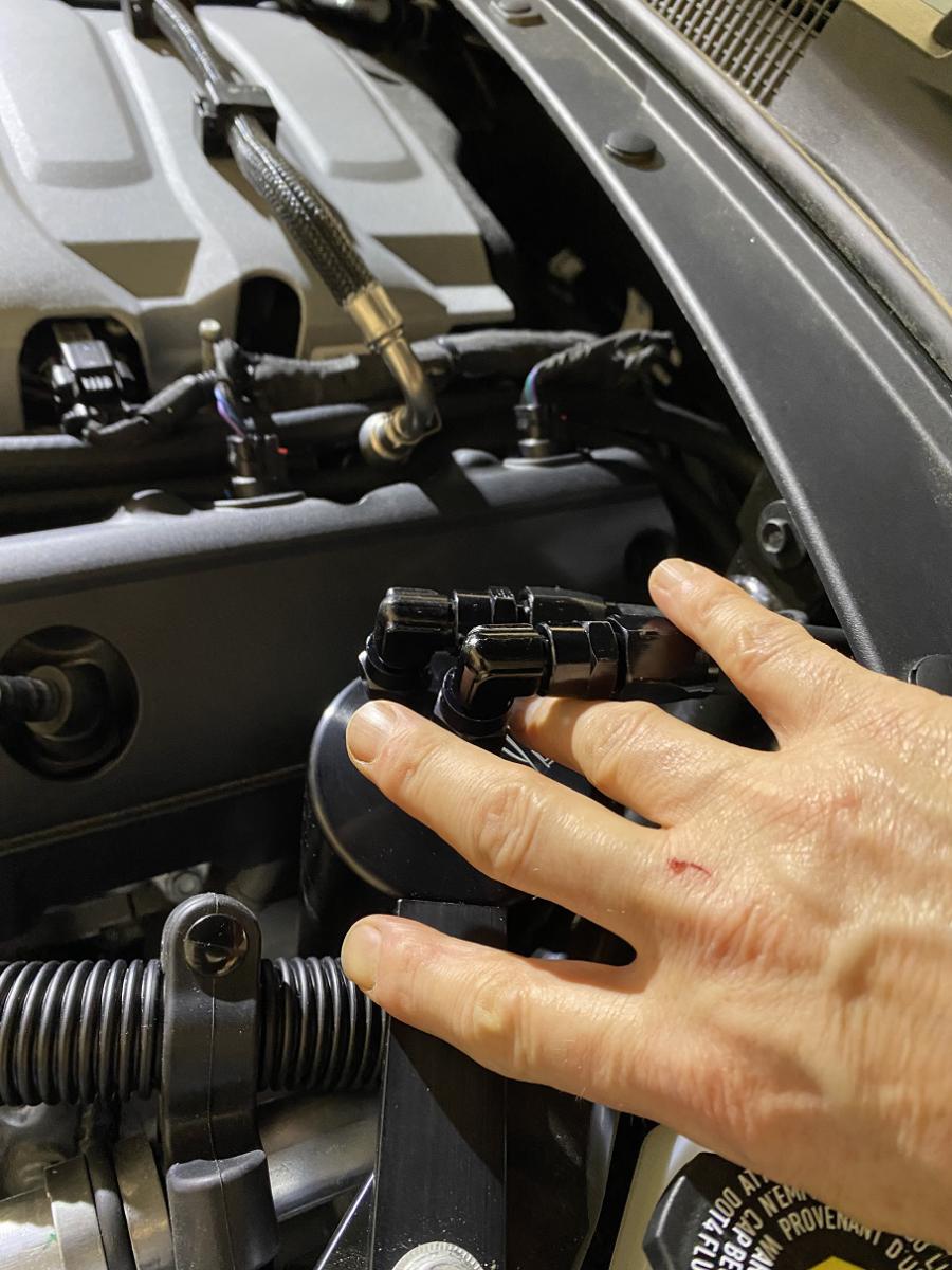

It's not bad, I can reach the catch can and unscrew it without removing anything else. The Mishimoto does have a nut on the bottom that you could put a drain hose and valve on if you wanted to.
Basically I use 2 hand and reach on either side of the struct tower brace and can get about a quarter turn per try until it is loose then I just reach in from the front and unscrew it easily... I've emptied it probably 8-9 times this way, never a problem...

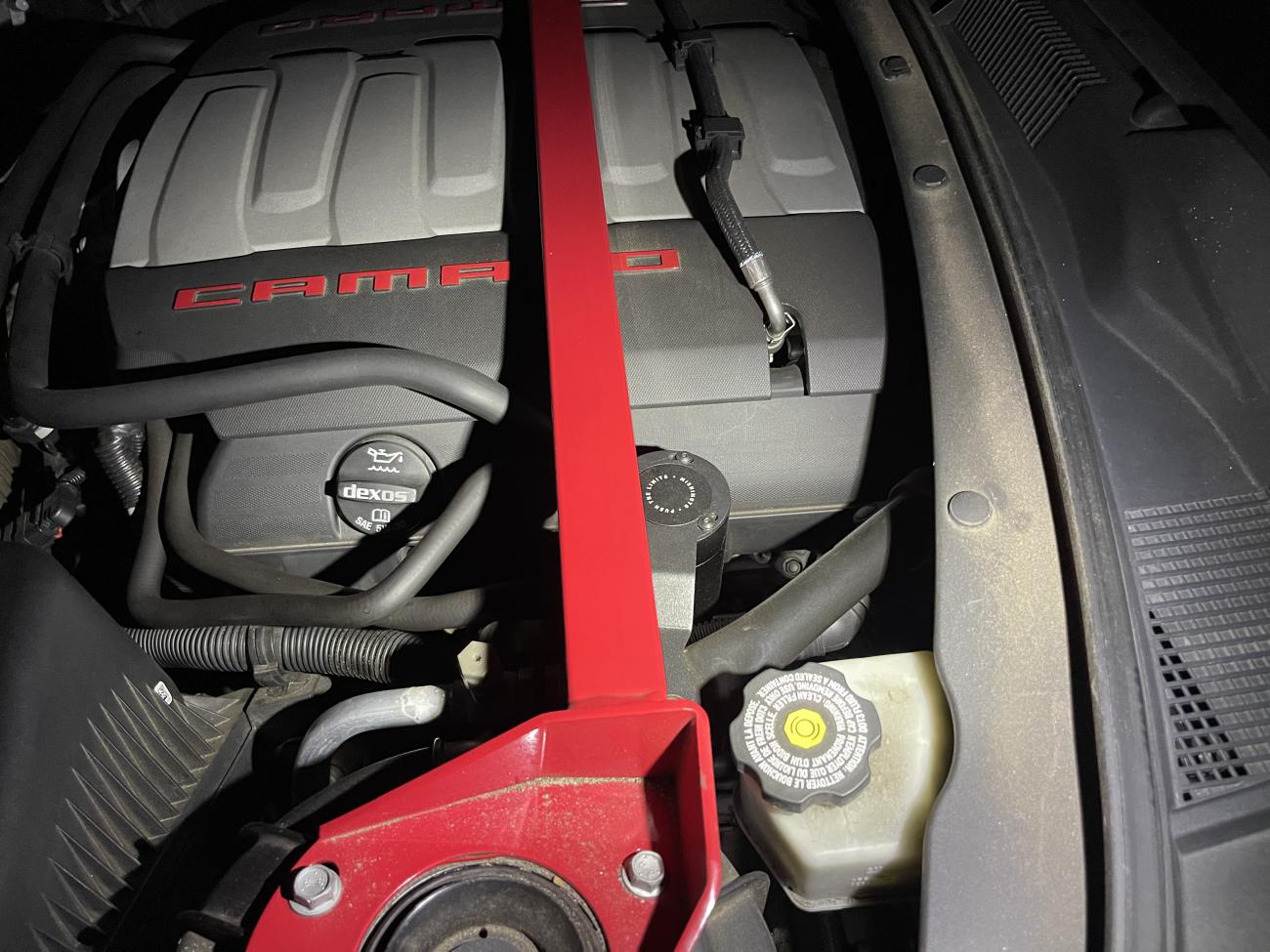

Just wanted to throw this on here since I didn’t see a pic of it. BMR brace with the mishimoto CC. And yep, gotta clean the engine bay, I feel much shame…
