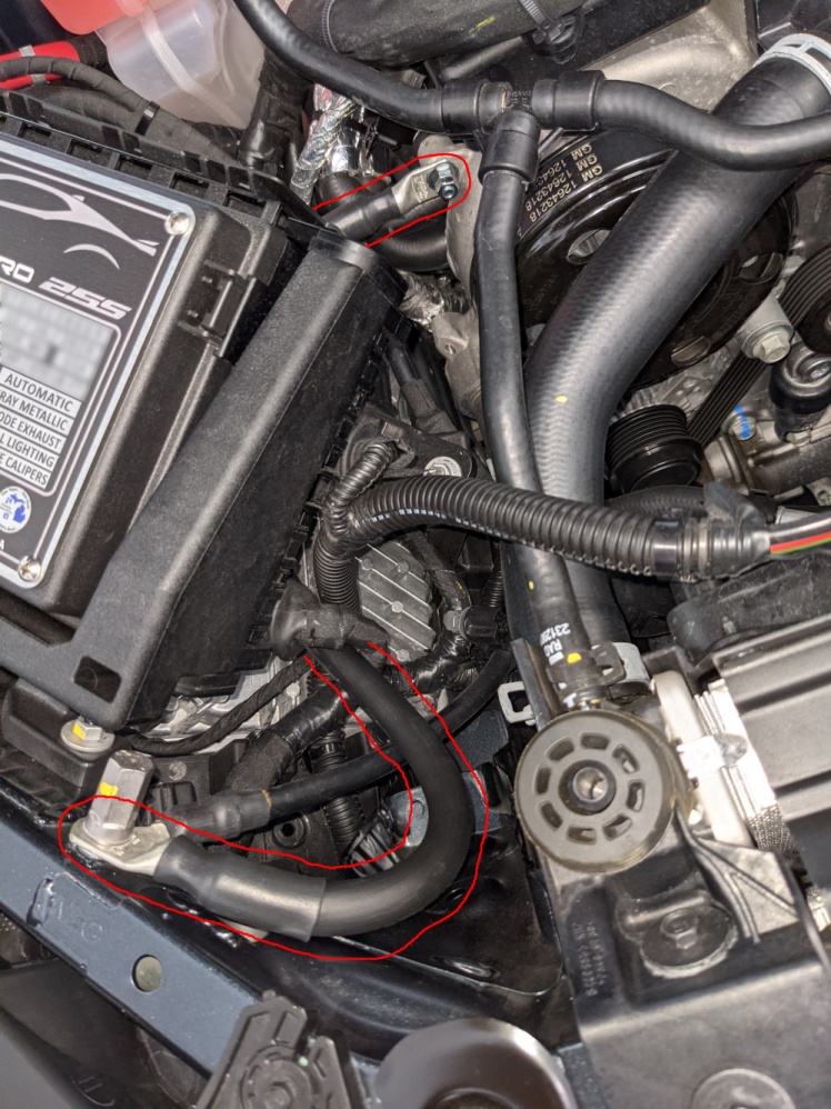

Just ordered from BATTERYCABLESUSA two 24" cables, I went with the 2/0AWG wire. What is the bolt size/thread?
Added an additional ground cable to help with the slow crank/hot engine issue...
Bought the cable from BatteryCablesUSA, 21" 0 Gauge (1/0), 3/8" connectors (M10): $12.81 + $3.97 shipping = $16.78 + $3.18 at Home Depot for a new bolt, nuts and washers... Total: $19.96 installed, took about 10 minutes...

Update: I wired the wired it to the negative post in the engine bay and onto the engine. It did NOT fix my problem (slow crank/no crank/single click from starter solenoid I believe) :(

Is the slow crank on a cold or a hot engine? Could you post a picture of where you connected the new ground cable if you used a different location than in this thread?

Slow/no crank(single click) is happening on warm/hot start. I connected the new ground at the same location as the pic a few posts above. There are days where it starts up with no problem. But these symptoms has been more frequent as time goes by.
