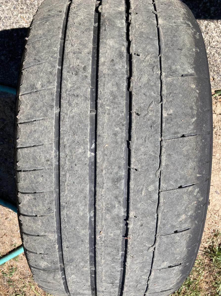

Rear
Attachment 1074451
Ken
Really enjoying this thread!
Question… and a bit late but curious why you think more neg camber is needed on the rears. Is that based on inside/center/outside tire temps or based on wear?
Looking at wear, it seems the outside shoulder barely has wear and the inside shoulder is worn all the way to the edge. Am I missing something?
Also, how did you like the new square setup? I keep thinking about doing the same in the future.
Dabjbr is offline   Reply With Quote
Based on wear and the inside is really not that abused.
Square setup this weekend!
