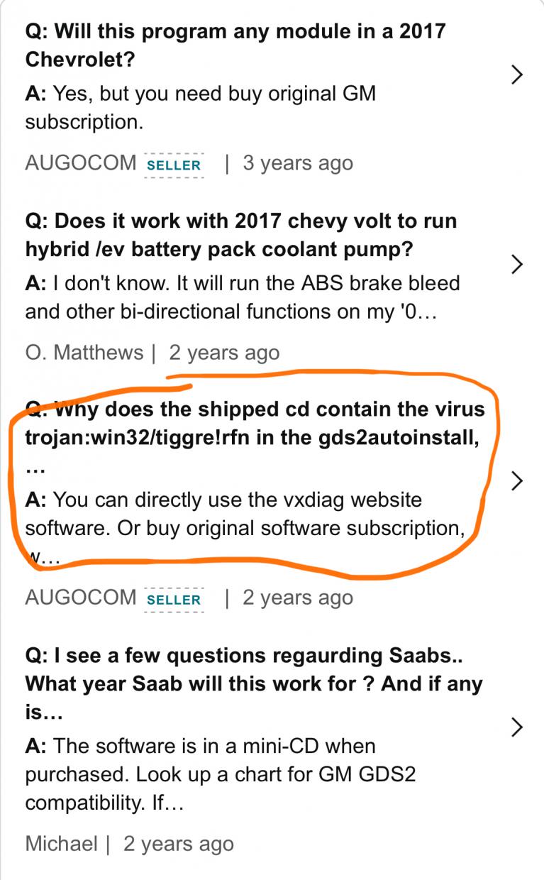

Well this is unsettling.

It's not a virus, its because of what is used to crack the GDS2 software. The right way to do it is to install VMWare on your PC or Mac, and then build a Windows 7 VM and install the application. I've done this and used GDS2 for over the internet updates and the Tech 2 for module controls. The VM is isolated and shut down when not in use. No fear of viruses.

Hey thanks Megahurtz for the insight and also the VM suggestion.
