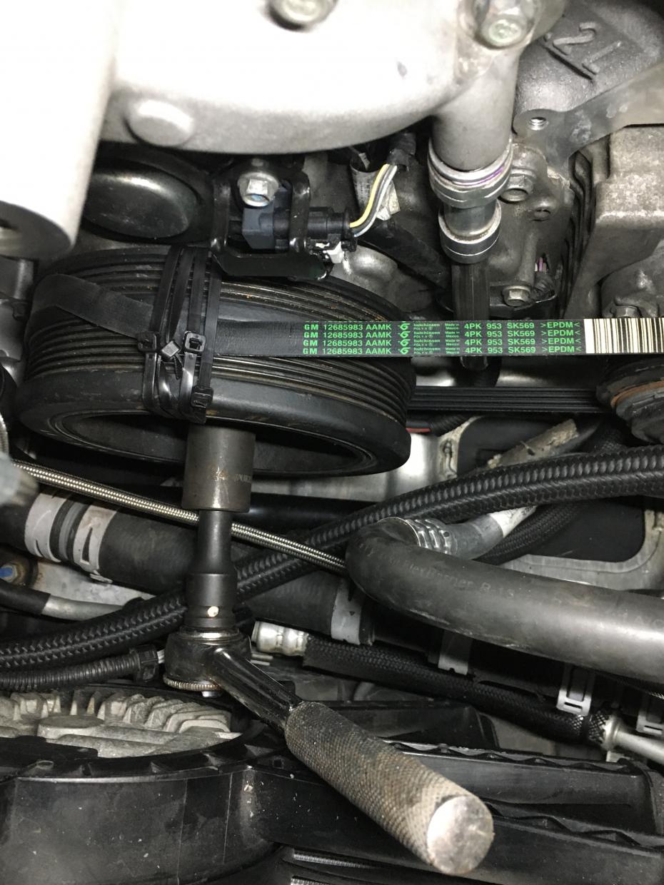

Factory crank pulley does have openings to use zip ties. It works. Took more time getting the zip ties in there than actually walking the belt on. Did it myself w a brand new Ac delco belt.
I zip tied the belt about 5 o clock on the back side of the crank pulley. Left the top of the belt off the crank. Put the belt on the top of the Ac pulley. Pushed hard w my thumb to keep the belt on the Ac pulley and turned the crank clock wise. You can see the belt was pulled from the back side to the front but once I cut the zip ties and turned it over another 1/4 it aligned nicely.

Good job, Choda. Looks like the way to go for the guys with the factory LT1 pulley. I don't think this will work for the LT4 though.

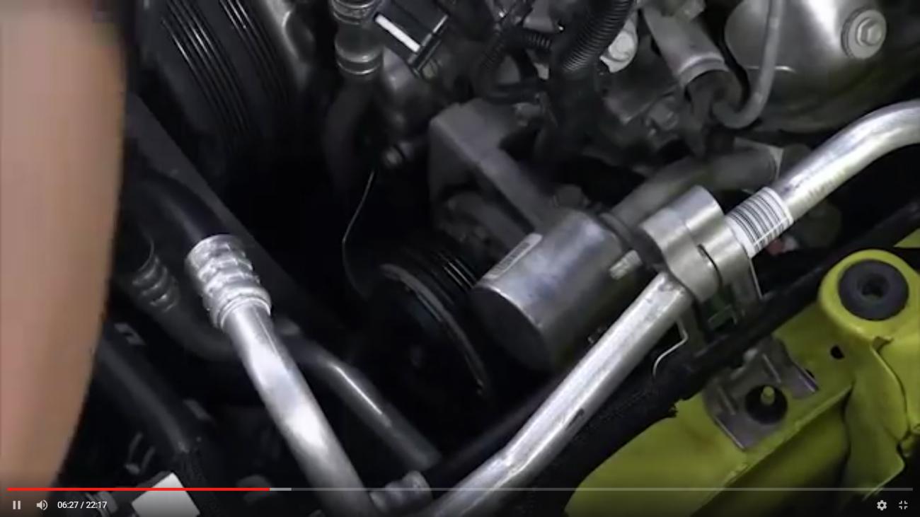

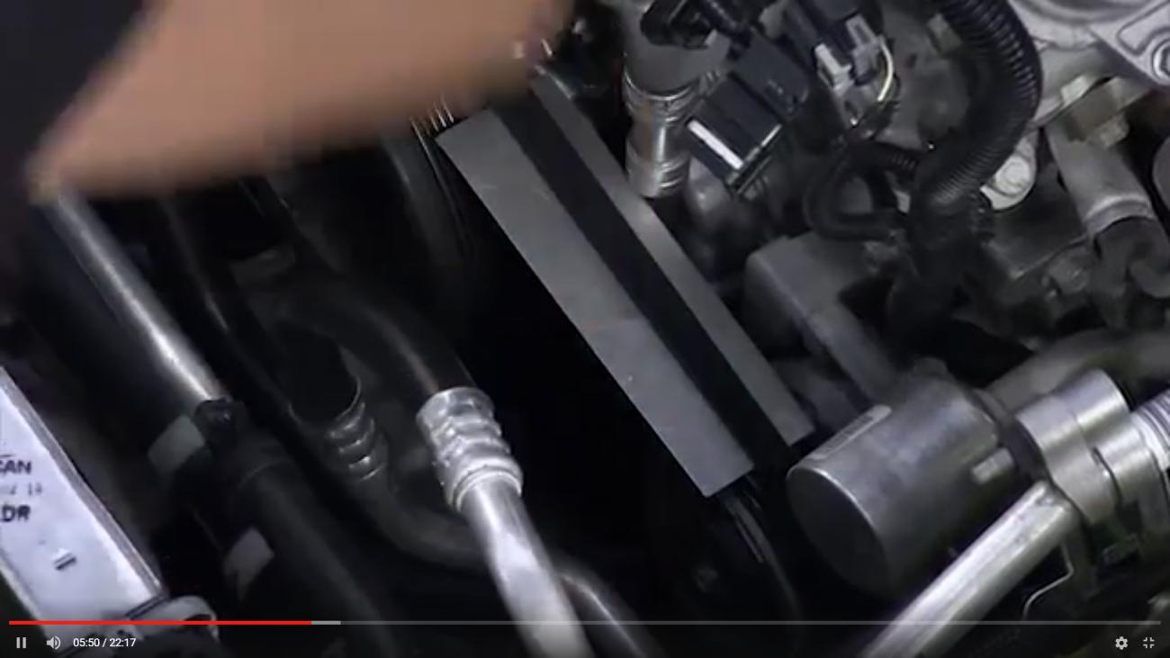

I watched Boggi with All Girls Garage do it in person as they worked on the wifes SC install. I also included the video the producer sent me but sometimes Discovery channel blocks it so I took screen shots for ya...
no tool needed thin metal is all!
1. find a piece of thin metal that pliable ( i used a band clamp) Pictured
2. Place it between Harmonic balance and AC pulley (pictured)
3. Draw it around the ac pulley by turning the crank bolt (pictured)
4. Use cheat bar if need be (pictured)
5. Once its around all the way use a pry bar (pictured)
6. Reinstall by placing the belt on the crank pulley 1st then turning engine over by hand as you guide it around the AC pulley by your fingers (may take 2 people) 1 to turn crank the other to put pressure on belt so it can be started.. Can also start the belt and the metal tool at same time to make it less harsh on the belt jumping the lip of the AC pulley.
