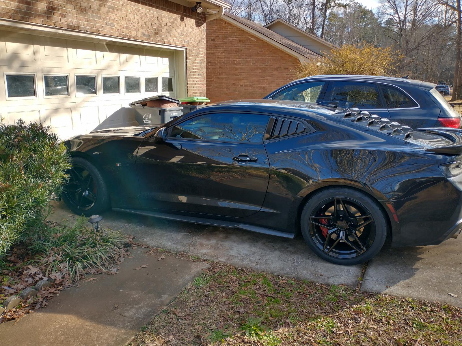

Originally Posted by BrandanK View Post
Any photos Doc?
Brandan
This is the only one on my phone but l can take some more this evening if you want?
2017 2SS A8 TSP LT's, ported msd/95 mm, e85
How do you cope with the window louvers with already so so visibility on our Camaro's?
CamaroSSStlfan is offline   Reply With Quote
It's not nearly as bad as it seems, plus I'm 6'4 so the way my seat is adjusted those windows were almost useless before hand. The louvers chop up what little view there is but don't really cause any issues in my case.
