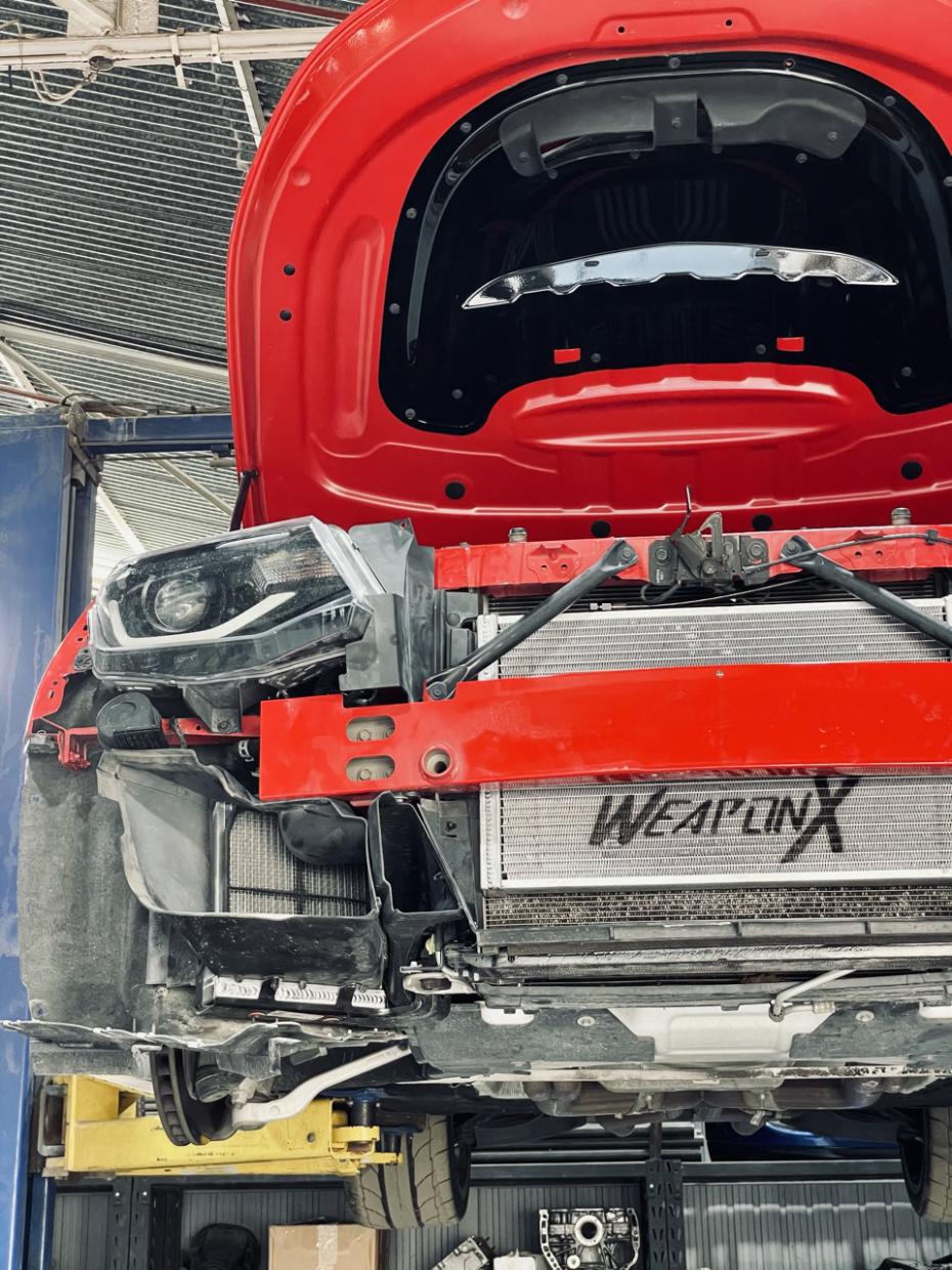

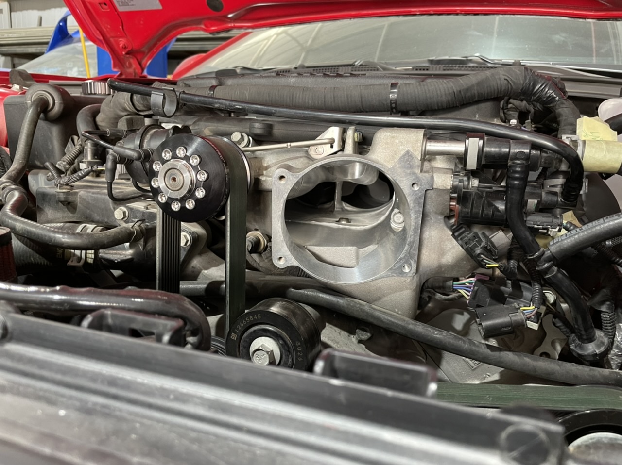

ADM V2
Just did Kong ported blower, 103TB and Weapon X triple heat exchangers
Bleed procedure was a walk in the park
I plan on going this same route, I really do like the oem look adm did.
