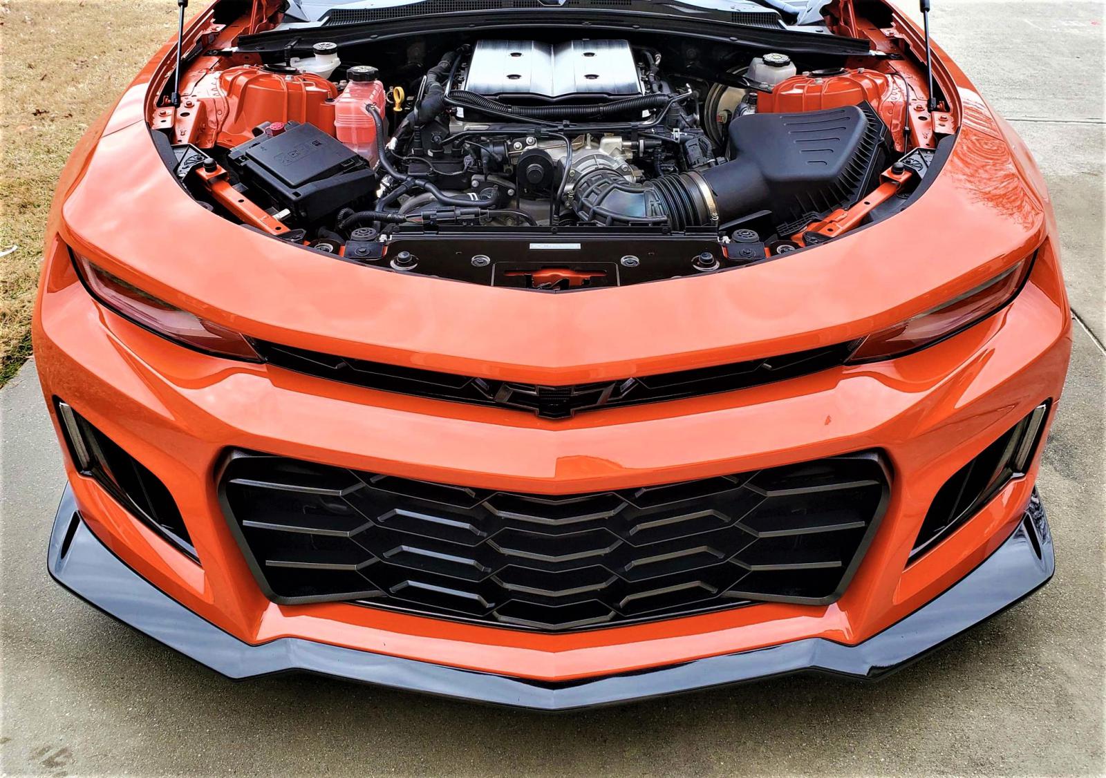

I went with the 1LE grilles for airflow but kept the fog lamps/etc for the side intakes. Had them paint matched Mosaic Black Metallic. I didnt want the airfoils and stuff because I dont have the 1LE spoiler and I dont want the drag. All airflow, neat half-way look and all fit great.
The 1LE parts are satin plastic vs the Mosaic Black painted ZL1 parts, so if you change the splitter/grilles/etc, the side skirts on your car and the ZL1 oem spoiler etc wont match fyi.

I am in the same exact boat as you FoundNemo, your car looks great! Honestly the lower grill really isn't that bad. The upper grill by far is the hardest part of the whole ordeal if you are just doing the grills and the splitter. I know from others the bezels end up being the worst but I'm sure the upper grill is a close second. Also look out for the plastic screws that use square bits on the energy absorber attached to the bumper itself, took me a minute to figure out why it wouldn't come off.

Thx FrostZ! It definitely was more of a PITA than I expected. The wiring harness being zip tied 20 times to the bumper didnt help either, but got her done in the end.
