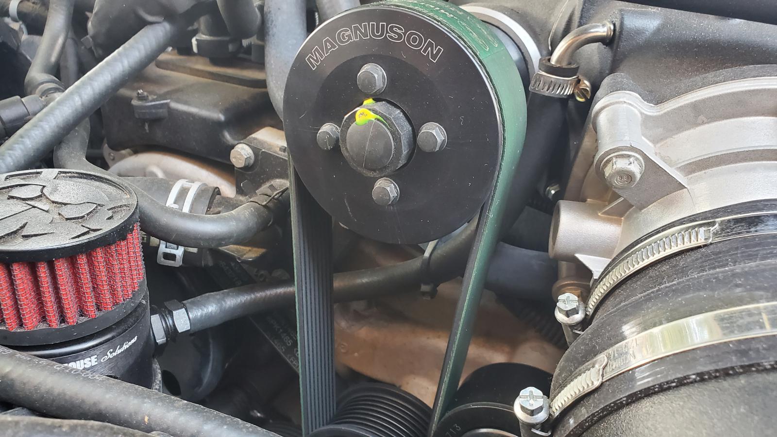

Old 02-25-2021, 08:57 PM   #6
NeckRomancer
NeckRomancer's Avatar
Drives: 2016 Summit White 2SS A8
Join Date: Apr 2019
Location: NM
Posts: 3
This is how mine is setup if it helps any.
