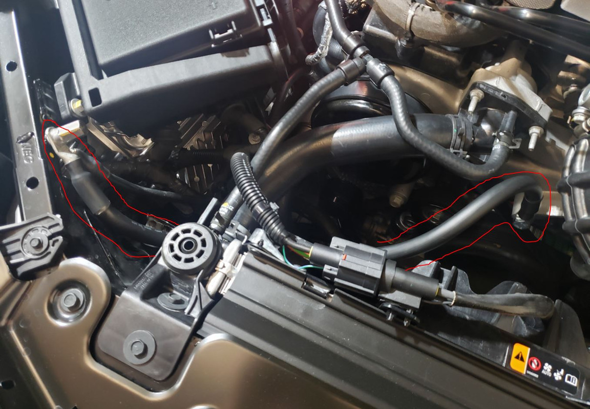

Okay, so I just installed the cable on the sound tube bracket mount hole.
I have the sound tube so bolt is there, but I'd bet that hole is tapped even if the car came without the sound tube. If it didn't, the thread is 10mm x 1.5 pitch (I think...it's metric coarse so likely 1.5). A 1/2" length bolt will be sufficient.
The existing bolt is #50 Torx head.
I was able to remove the bolt and simply slip the terminal in between the grommet and casting boss. Plenty of thread to work with so no danger of stripping/pulling threads out when tightening. The grommet is captured on a flanged spacer, so the bolt tightens on the spacer and hence the terminal without "crushing" the grommet for the sound tube bracket.
I mounted so that the cable goes upward, keeping it away from all the pulleys and belts. It curves up and over then back down next to the fan shroud and then up to the NEG body post. It's not rubbing on anything and will not chafe.
The cable I used is 1/0 AWG with 3/8" terminals, which were perfect for both ends. Length is 29" hole to hole, but you could use 27-31" and be fine.
Nice! Thanks for posting the details and illustrated pics. We now have another way to get this ground cable attached on the engine side.

Biased opinion here but the sound tube bolt is the absolute easiest to do. Don't need a longer bolt as with the water pump install. Don't have to cut one terminal end to "fork" it to fit over the tensioner bolt (plus the nightmare if you remove the tensioner bolt all the way). And literally no other parts needed.
See my post a few above this. 24" will work fine with the sound tube mount location. I routed mine upward then downward to keep the cable away from the belts and give a nice lead to the body lug with no kinks or chafe points, but there's plenty of options to route it using a bit shorter than the 29" cable I used. Might even be able to do it the same way with 24", just a little tighter bends in the cable.
You literally only need a #50 Torx socket and whatever the body lug requires (an adjustable wrench works just fine!) to do it this way. Takes maybe 2 minutes to do the entire install!

Installed my 27" cable just now to the sound tube mount in front of the engine block. Was able to route easily to avoid rubbing/chaffing on the smaller coolant lines, similar to TP2SS.
13mm socket for the negative grounding terminal, 17mm socket for the M10-1.5 x 20mm hex nut. I used loctite 242 and torqued it to 18 ft-lb.
