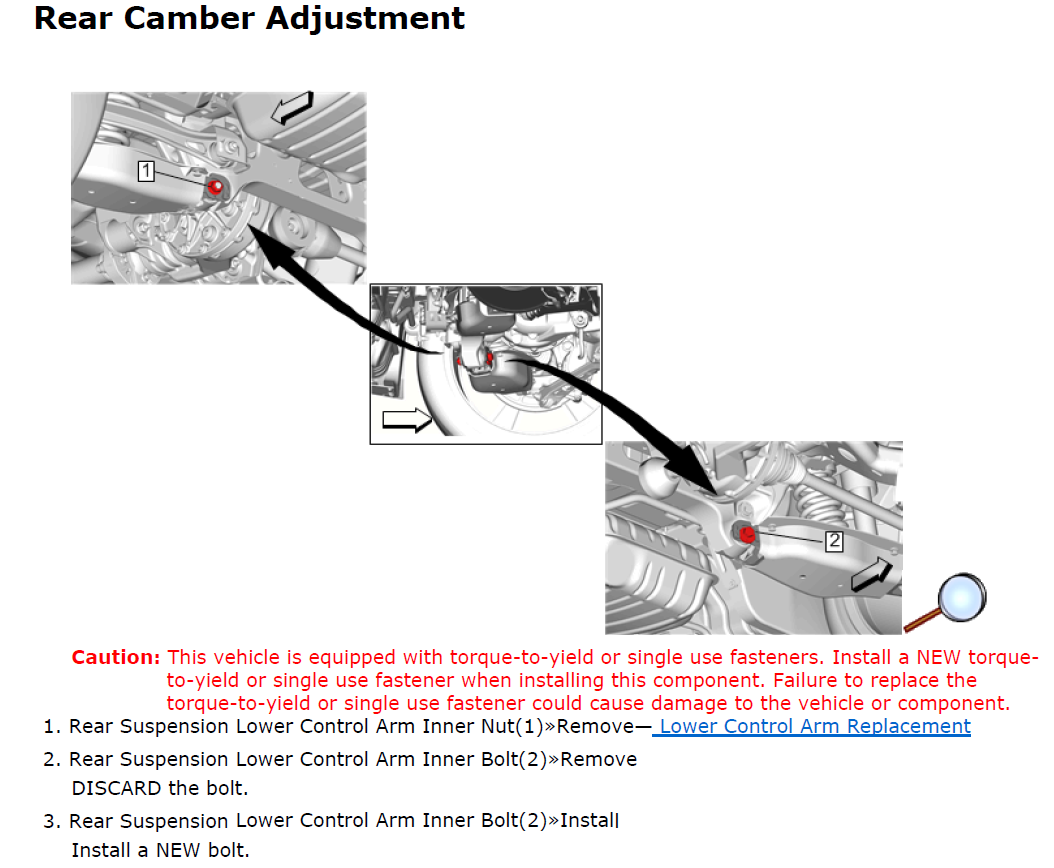

I dont have them all but here is a start...

oh i guess i did have them all , they are all in the pdf... its for a 17 but im sure the specs are still the same
